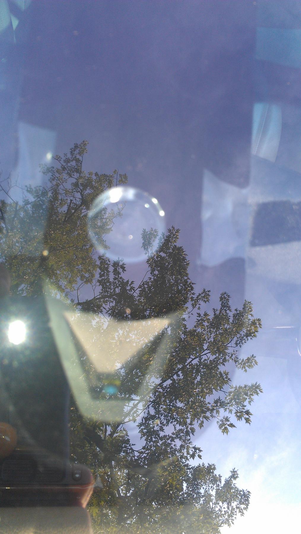

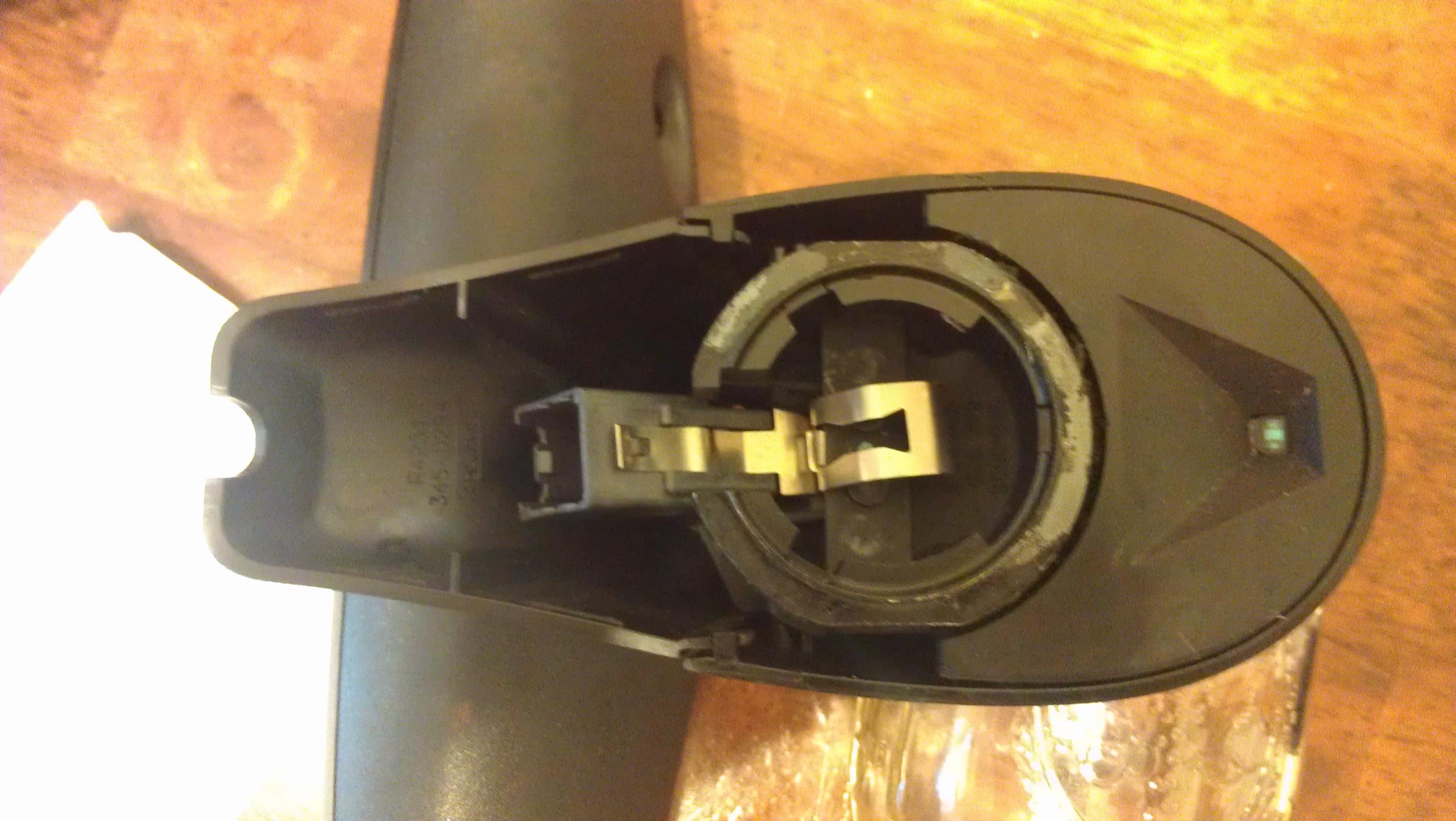

I have the auto dim/rain sensor rear view mirror. In this pics you can see that it is detaching right in the middle on bother sides of the round part in the pic. How can I make that restick. Right now the mirror is hanging on from the bottom and some a few sticky back things I put on to help hold it in place.

Where do I get the black sticky stuff that you see in the pics I posted. You see at the center of it both sides of the sensor is where it pulled away allowing the mirror to come loose. The rain sensor is attached still. Where do I find that black piece that goes all the way around. I pull it all off since most of it was pulling up. That seems to be what was holding up my mirror.

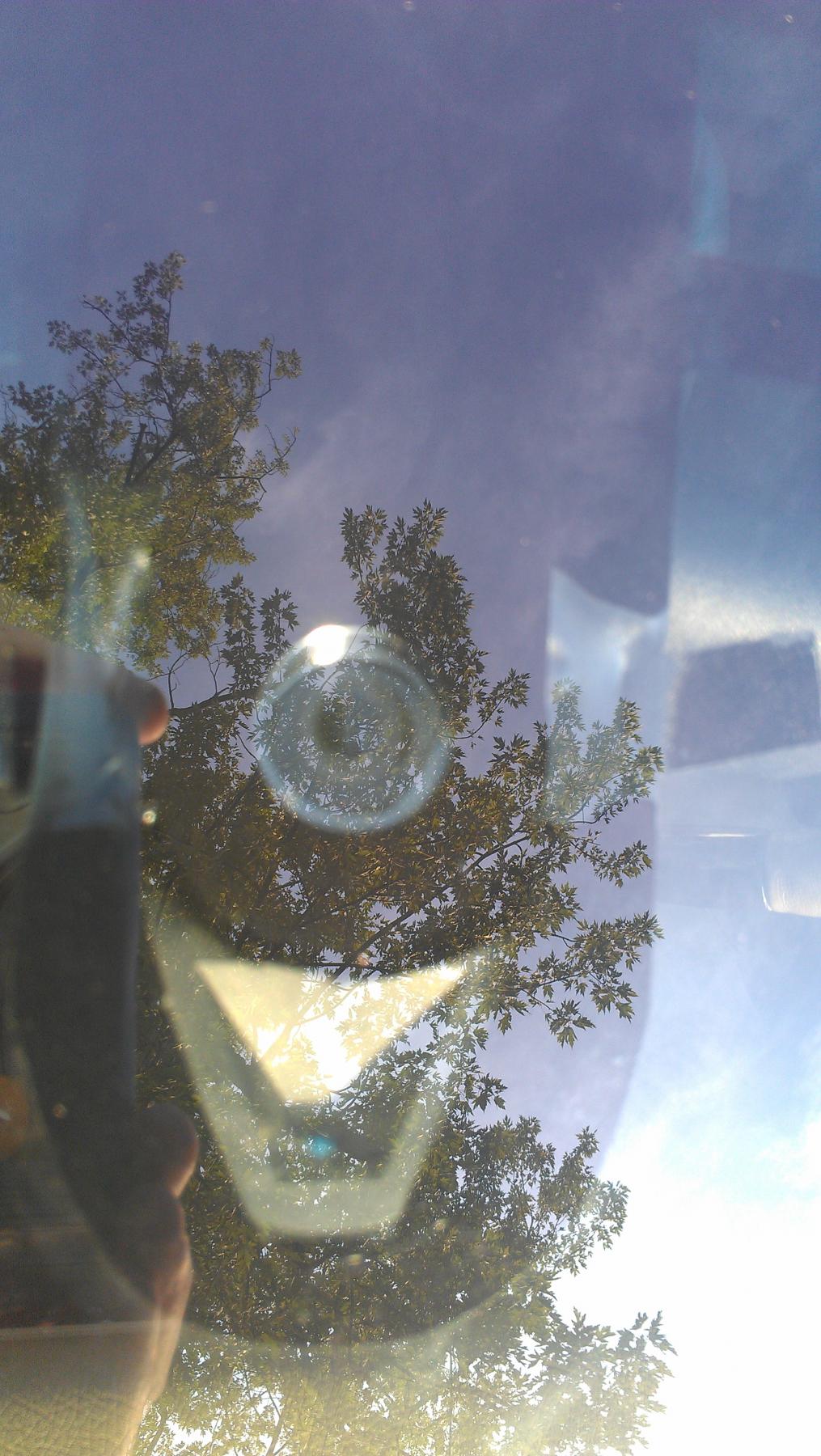

This is my mirror. The center circle sits over my rain sensor. On the flat metal circle there was a hard black adhesive of some type that held my mirror to the window I think.
Does any one know on this??? Seems everything I find here is pre 2003 and is diff. I don't even have a clip in mine as noted on the pre 2003 models. I just have that pressure metal that pushes on the sensor I think to keep tension on things.

Pic

you can see where I have some of the black stuff scrapped off the round metal circle.
