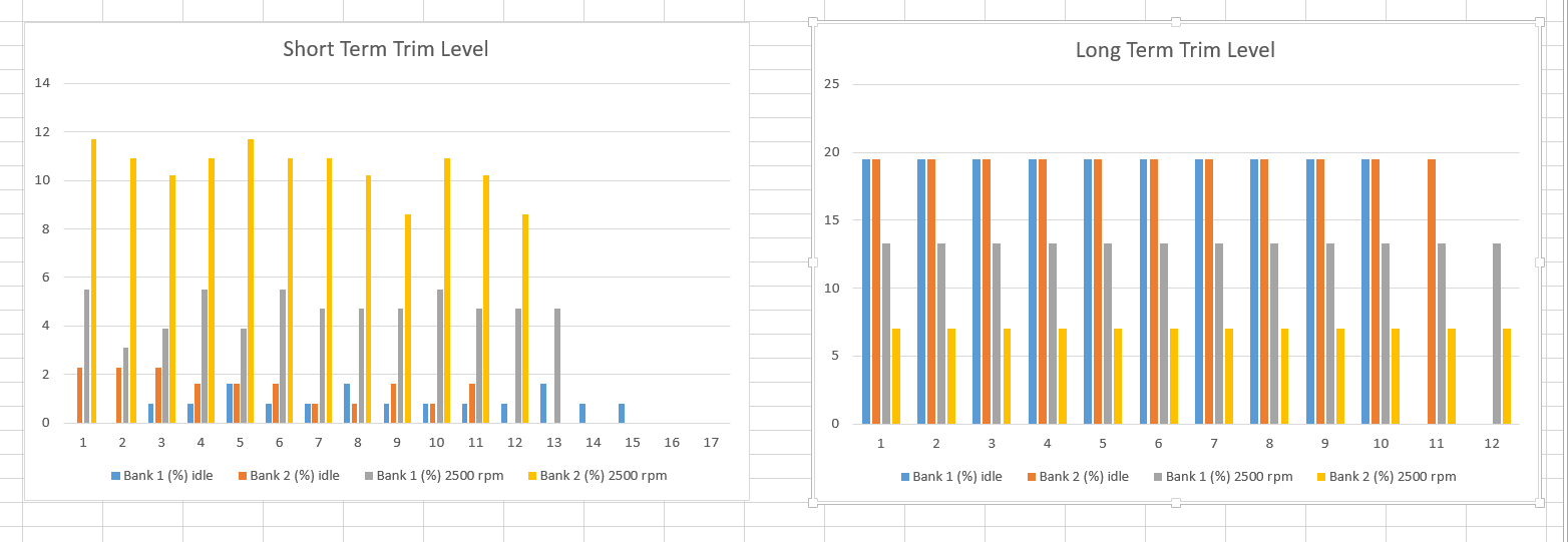

I'm working through resolving these error codes on my 2003 XKR with 104417 miles.
Reading previous posts has been a great help.
I bought the ODBCOM diagnostic tool and it works w/o issues. This is not a self-contained device but consists of a hardware device that plugs into the OBD2 connector on your car and to your computer via USB.
I did a baseline and measured fuel trims and O2 voltages.
The plots below shows the short and long term fuel trims at idle and at 2500 rpms. (the levels are sampled sequentially rather than at once; for example; about 10 seconds of STTL bank 1 at idle, followed by 10 seconds of STTL bank 2 at idle, followed by 10 seconds of STTL bank 1 at 2500 rpm, then 10 seconds of STFT bank 2 at 2500 rpm. This was repeated for the Long Term Trim Levels.
Clearly there are problems as fuel short term trims are high at 2500 rpm and long term trims are high across the board. Just a bit confused why bank 2 short term trim greater than bank 1 short term at idle but bank 2 long term less than bank 1 long term at 2500 rpm.
Anybody have an explanation?

I read the first post and was about to post "you have an air leak downstream from the MAF." But I guess you know that !
The upstream O2 sensors are saying 0 which is indicating lean as you have "pirate" air coming in, the downstream are saying cats not working as its too lean.
The air leak (unmetered air) has most affect at idle, at higher throttle =more metered air coming in so the air leak has much less of an affect.
Fix the holes any you should be good.
