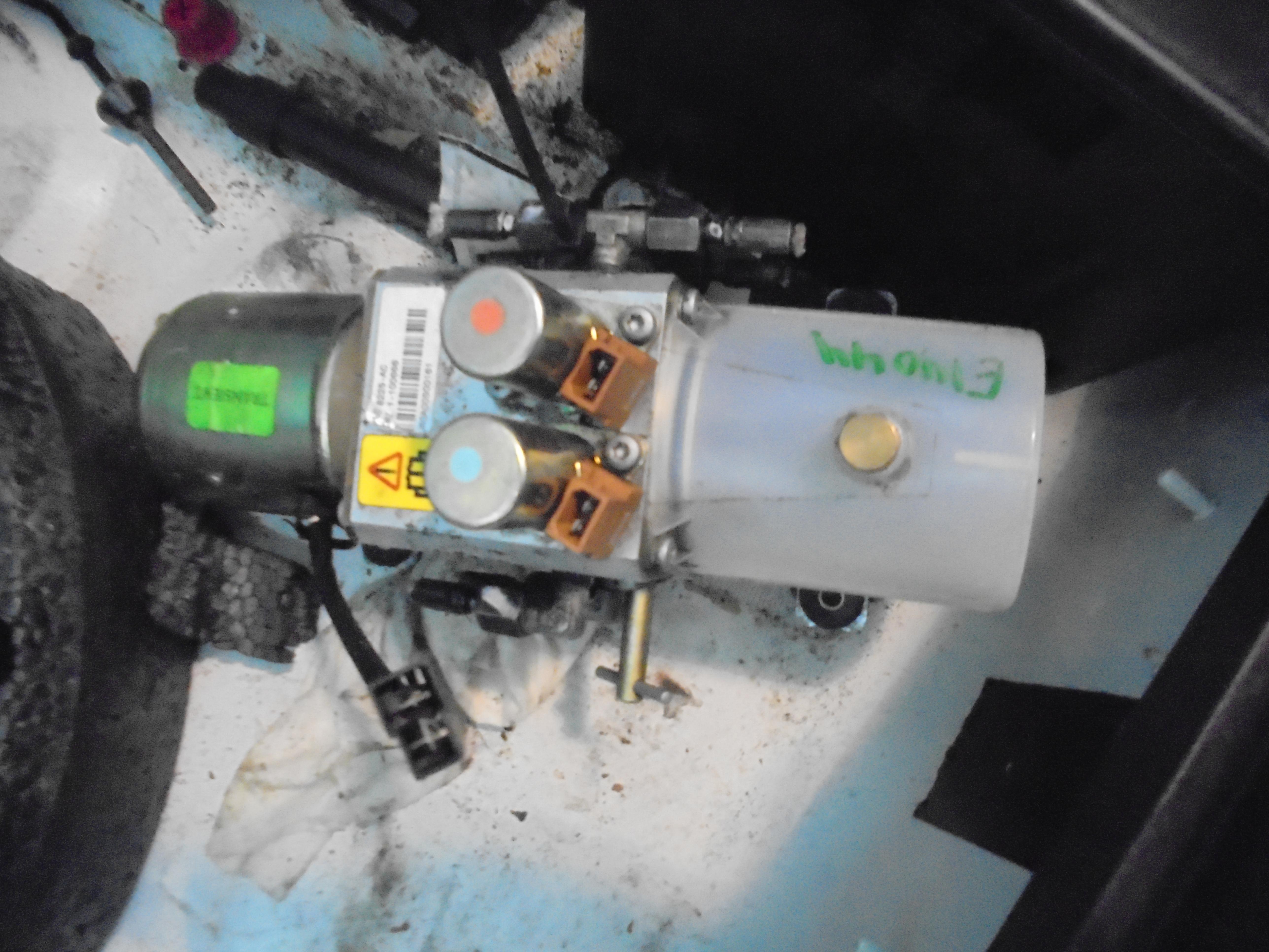

Having issues with this top motor. We are missing the wires see pictures. does anyone know what the part is called that we are missing. we are an autobody shop doing this for a retired Vet. (free of charge) if anyone could help us please do 954-572-4905 ask for Desi

That's where the top control wires plug in, they should be hanging somewhere on the right side of the trunk where the pump goes. If you need the plugs check the marketplace for sale, several members parting out cars and they should have the hardness plugs.

Look on the right side of the pump rack and you should see a plug attached to it and if you are lucky you will see the leads that go to the pump. Remember that the leads are color coded to the solenoids
