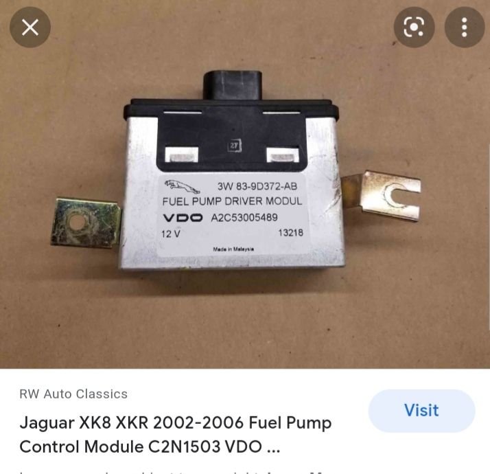

Yes! How would one “bypass the VDO regulator to energize the pump... to see if it will run” ? By the way, what is a VDO regulator?

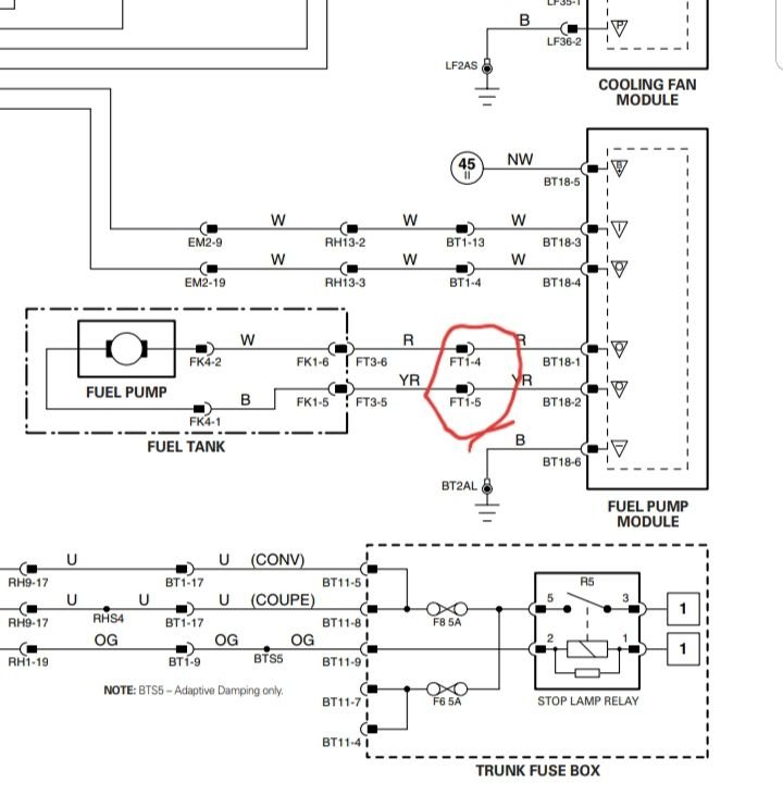

Cool. It's not too tough, but let's be careful here.
Anyone hear any mistakes in my explanation just say so...
If you feel unsure or uncomfortable DON'T do this.
Just have a look see...first.
Confirm - your car is a returnless fueling system - post MY 2003. I've worked on my 04 XKR and I believe the 2003+ XK8 is the same. A returnless fueling system. If so,,,
The fuel pump regulator (FPR) receives info from the ECU about how much fuel (pressure) to provide to the rail (don't worry about all that right now) then powers the pump... The regulator is a little silver box on the RH side of the trunk/boot. Remove (as best as possible) the carpet cover covering the stereo and nav system and you will see it (see photo). There is a red (R) and yellow red (YR) wire coming out of it. It's as simple as melting back a little of the YR insulation and twisting a wire into what is exposed and finding a suitable ground.
With ground hooked up & key turn to on, pump should run full blast for 2 seconds (prime) AND continue IF the car starts.. I believe the car (ECU - fuel pressure regulator/FPR) shuts down/won't power the pump between initial key turn (prime) UNLESS the car actually STARTS. What you'll be listening for is the 2 second prime...
Once you ground that wire and turn the key, listen... If that doesn't give you a definitive, turn the key to start the car. If the car starts car will run rich, fuel pressures at the rail will be near 70 - so DON'T drive it - but DONT panic. There will be no harm. This is just to test to see if the pump works.
You could also tie into BOTH, the red (R) and the yellow red (YR) wires and apply 12v (neg battery terminal and positive battery terminal) right there from the battery just to see if you can hear the pump spinning BUT,,,, DISCONNECT the plug/connector on top of the VDO FPR before doing that... Just because...

No. Not really. The car won't like it (extra fuel, high pressure at the rail/bad trims) but I actually drove my car this way (super sparingly) until I solved my pump problem. As you can see in the wiring diagram,,, your just powering the pump.
Old Jul 8, 2022 | 05:33 PM
JayJagJay's Avatar
Joined: Sep 2016
Posts: 4,277
Likes: 1,314
From: New York New York
I should add. This will indicate a pump problem only pretty much. If the pump runs/works it will not explain why you are not getting the "ok to fuel" signal from other systems in the car...
Okay did the test but cannot confirm the fuel pump started by hearing pump. I tried to start the car but also no success. I hooked a test light but the light did not light when turned on the key.
I also removed the blue cap on the fuel rail and pushed the the little air press type valve but no pressure or fuel was released.
