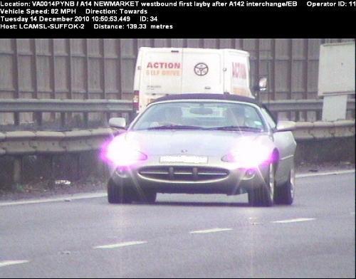

You could use an adhesive Licence Plate (Like an e-type) and move the growler badge on to the bonnet (Hood). That what I have done in the UK.

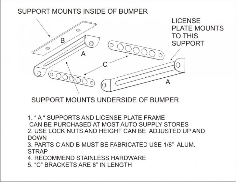

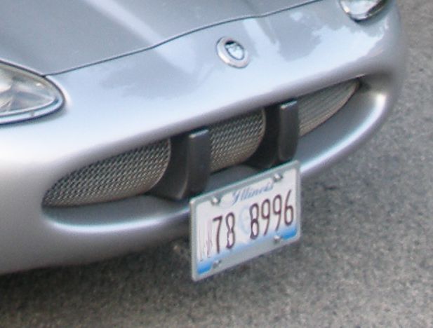

Here's a print and a photo of the plate mount that was on my XKR. I don't use it, but it was adjustable on height. It's illegal in Illinois but I just take my chances.

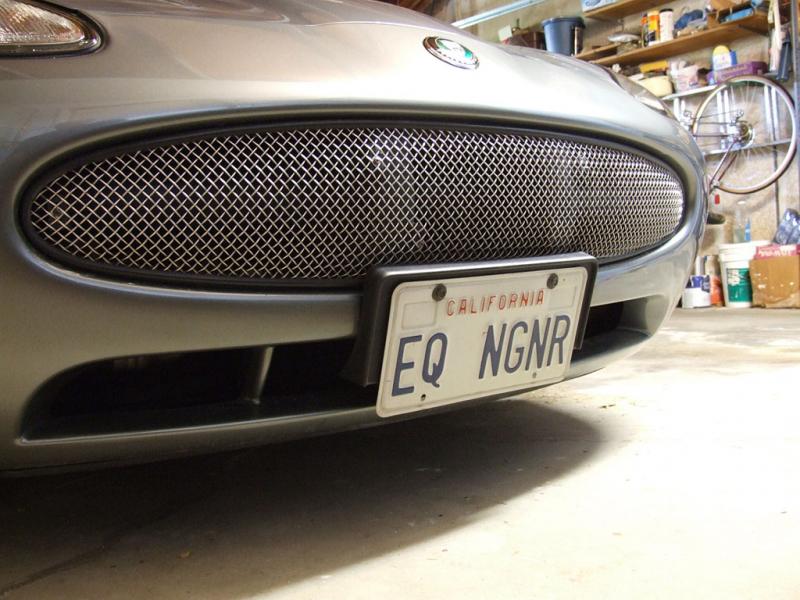

This has come up a few times and I always forgot to post a few pics of what I did. Kalifornia has gotten much more strict about passing out chickens**t tickets for things like no front license and window tinting and I was the recipient of a no-front-license ticket on a Corvette that had been front license-free for 13 years.
When I bough the Jaguar, the previous owner did not have a front plate mounted (he barely drove the car) but he did have the plastic mounting piece from Jaguar. So what I did was mount the plate onto the plastic mount and then secure the plastic mount to the lower splitter piece by wrapping long zip ties.
The result is similar to the aftermarket kits I have seen advertised that are a couple of $hundred. For some reason the lowered mount kits for the post-2003 models are ridiculously high compared with the earlier models.
Why is it illegal? Is it something to do with the long stays that hold it in place at the bottom?

Frog, I'm thinking it's plate height. Minnesota has the same thing.
Yeah, we have all sorts of height restrictions here in Europe, too, though in this case it doesn' really appear to be any lower than mine. Any higher and it would restrict airflow to the rad It must be a bit difficult sometimes when you have to find a suitable place for your US plates on a European car, as they are designed to take our much wider shallower plates.

As quoted by Frog
Frog I meant it's illegal not to have one I took mine off and haven't put it on.
