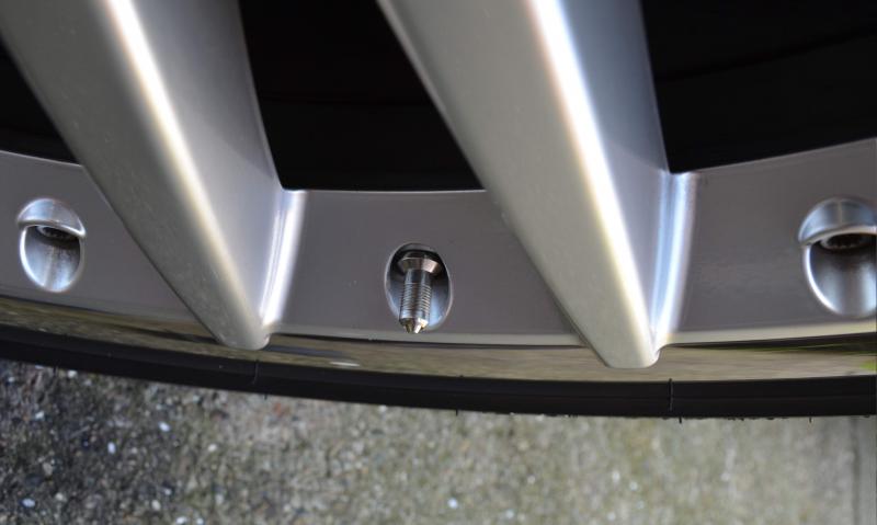

This has happened on each separate occaision I've tried to adjust the pressure in the tyres over the last month of owning my Jag; the worst being a 30min monopoly of the service at the local petrol station to do all 4 tyres (l now take a pocket of change with me...)
The issue I've got is that when I fit the pressure pump from the station on to the valve adapter it doesn't seem to fit properly, and you can clearly hear the hiss of air coming out whilst I'm trying to insert air. Eventually it does inflate but painfully slowly.
The valve adapters all are in excellent condition and the screwing in to the holes is faultless. It does not matter how hard (or softly) I push the air pressure 'gun' on to the adapter I get the (amazingly annoying!) hiss of air escaping! The foot pump/pressure guage I have at home also provides me with the same result.
Any advice greatly welcome!
Jules

I've found it impossible to tighten the extension sufficiently by hand to make an airtight seal between the extension and the wheel and have been using pipe-grip pliers. Perhaps you're actually losing air at the extension to wheel joint rather than the air hose nozzle connector?
The only solution I can think of to be able to tighten and remove the extension easily is to lock a pair of hexagon nuts together on the stem so a spanner will fit...........

Old Aug 13, 2012 | 03:23 PM
Stumpy's Avatar
Joined: Nov 2011
Posts: 581
Likes: 208
From: Devon, UK
I don't know if it is possible to damage the valve adapters without breaking them!?
I have 20" Detroit wheels and can check/inflate all 4 wheels in about 10 minutes, now I have gotten used to the procedure.
The tyres normally only need a pound or two, so I do it at home with a double barrel foot pump. The pump hose clips on without any leaks and I only have to screw in the adapter finger tight. (+ I don't trust the station pressure gauges!)
Are you using the correct pressure? F=32 psi R=30 psi
Are your adapter rubber sealing washers OK?

Old Aug 13, 2012 | 06:33 PM
Originally Posted by Stumpy
........... I have 20" Detroit wheels and can check/inflate all 4 wheels in about 10 minutes, now I have gotten used to the procedure. The tyres normally only need a pound or two, so I do it at home with a double barrel foot pump.............
Derek,
Double barrel foot pump! You must be built like the proverbial brick s*******e. I'll not be picking any fights with you.
Gave those things up after almost gasping my last twenty years ago blowing up a tyre from flat on my LWB Land Rover Safari. It's the plug in compressor nowadays for me.
If the extension was twice the length, it would be a lot easier to screw in and to release. Maybe my hands are too big but I find it very difficult to get a grip on the extension.
It's just a shame Asheville, NC is so far away. Otherwise I could go round to Mike's on a Sunday morning and drink his beer while he checks my tyres!
Looking at your and Redeye's wheels my Detroit valves may be easier to get at, less spokes in the way?!

Old Aug 14, 2012 | 07:45 AM
How does the valve recess on my Sepang compare with your Detroit?
There's not much room to grip the extender.
Attached Thumbnails 30 mins to put pressure in tyres!-dsc_0072.jpg   30 mins to put pressure in tyres!-dsc_0074.jpg

Old Aug 14, 2012 | 03:43 PM
Redeye's Avatar
Posts: 280
Likes: 45
From: Sunny North Devon, England
Appreciate all the feedback. The rubber seals on the adapter valves look in good order, but are skinnier than the ones shown in Stumpy's post.Name:  Untitled-1.jpg
Size:  12.2 KB Did notice tho that the area under the screws isn't sparkly clean so will spend some time on cleaning them up before I next try. Everything does seem to screw in properly & securely and it's really a case of the nossle isn't fitting on the adapter fully. You will see from the pic one of the adaptors is marked with black as I noticed the screwing part of it wasn't perfectly straight. The other one is fine.
I'll order one of those air compressors - will take away the hassle of hogging the air pumps at the station for ages - and the nossle fit could be better than service station ones.
