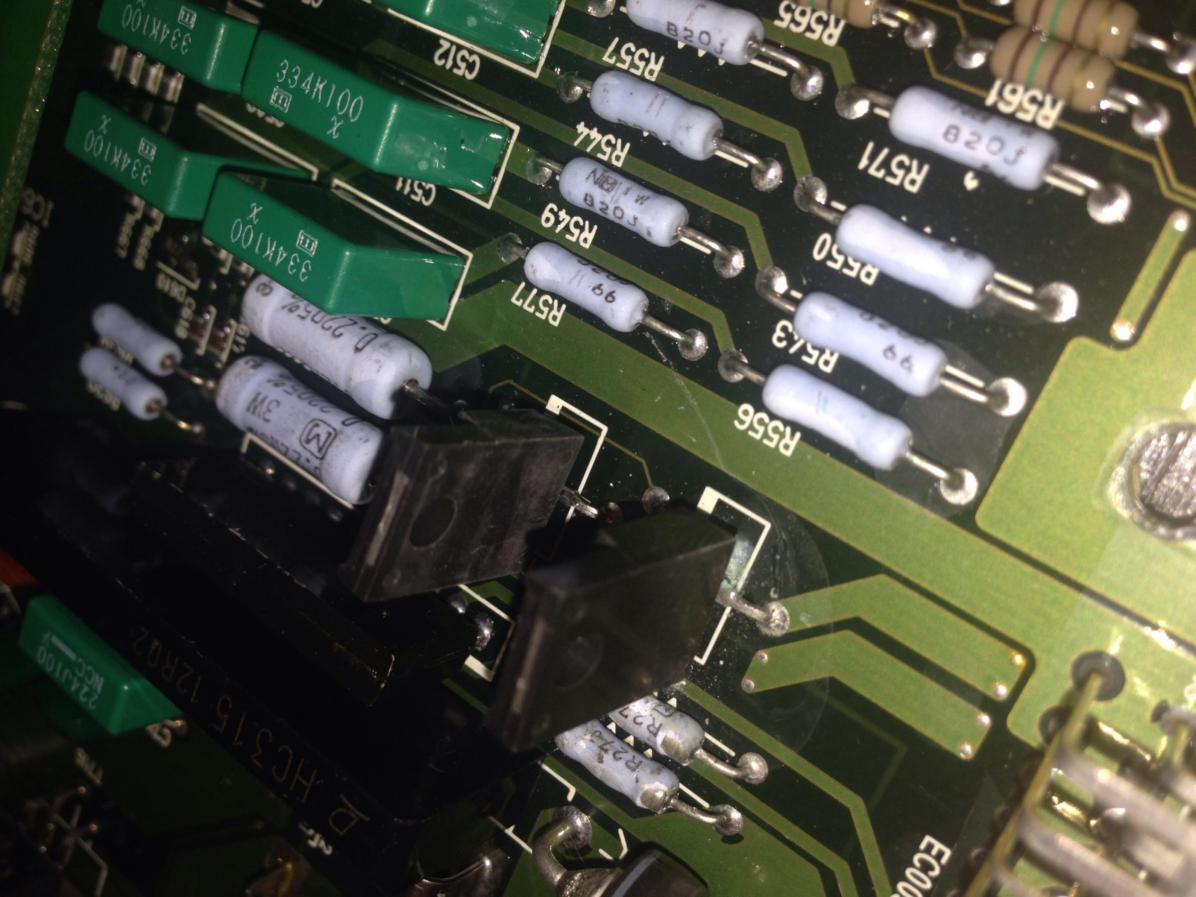

I tried swapping relays no difference. I monitored the voltage on pin two of the relays which is ground from the ecu. I found that's where the voltage is dropping out but it happens so fast it almost looks like a duty cycle. I removed the ecu again and inspected it. I did find (and I apologize as I have only a little experience with circuit boards)that one of the either black flat voltage regulator or a transistor of some kind has leaked some kind of corrosive fluid out. The only number on it is k943 it's flat and black and has 3 pins I measured resistance between all the pins and compared it to another on the board and it was very close to the same. No sure if I should send the ecu in or if the transistor is even causing a problem.
The only things that can leak are the electroytic capacitors (round cans). but the fluid can migrate. Post a picture for confirmation. This may or may not be your problem, but it certainly has the potential to be and will only get worse and eventually do irreparable damage to the ECU. It needs to be rebuit.

Here are some pics but it's kind if hard to see the only capacitor close is the only large one on the board.
The capacitor leakage is usually brownish. I do not see that issue in the photo. The whitish residue appears to be possibly flux residue. It looks more like evidence that the ECU was repaired once before. I do also see a bit of light green corrosion near the leads of that transistor. That is a bit worrisome, and looks like it also could have alternatively been moisture ingress. If it got wet in there damage could have been done.
