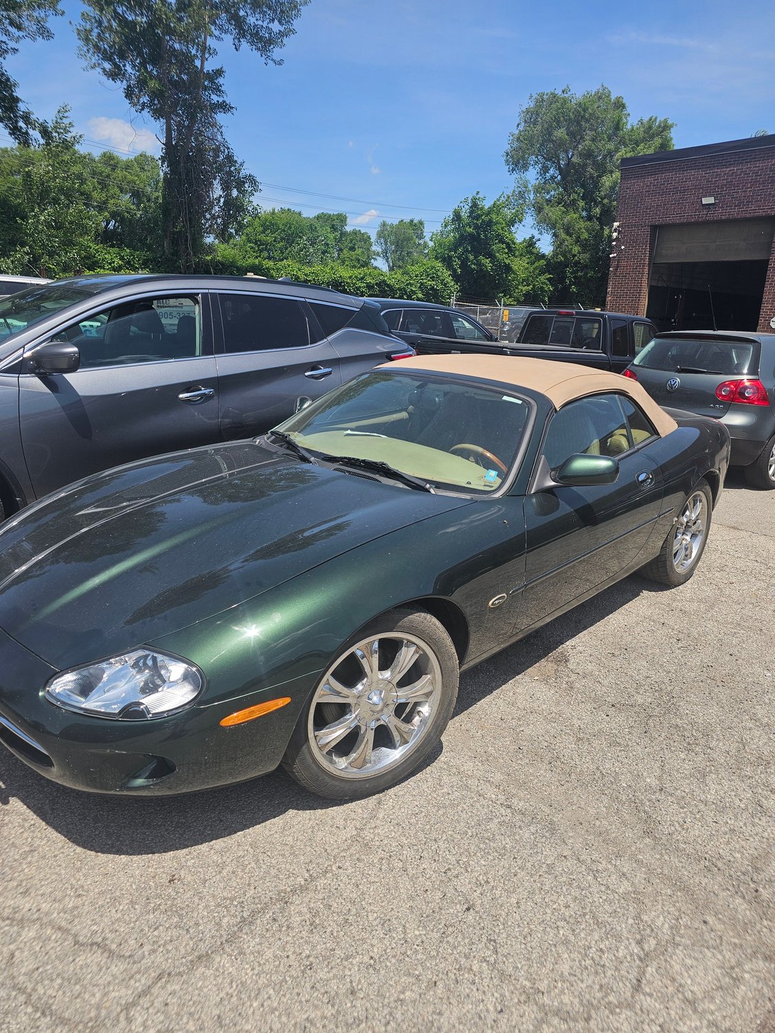

I have a 97 xk8 convertible with a LJA1410AH ecu that had the capacitors leak on the board and damaged the tracing as well,
I am looking for another unit if any one has one
I did find a LJA1410Ak and installed it and car fired right up no problem, i would still like to find a LJA1410AH to have the right one.

Yes I already did on the AK unit, I am going to attempt to repair the board, since I intend on keeping this car I wanted to find another unit as a backup lol if I am not successful
I found this car it cas been sitting for 10 years I picked it up from the original owner, it quit on him and he tried a couple of shops 10 years ago who couldn't fix it( im guessing they were not very good) so he parked it and never got back to it. I cleaned it up changed the gas and fluids, I knew about the ecu issues in these cars plugged in my scanner no communication and knew, pulled the ecu, put the one I found and she fired right up. So got a low mileage xk8 for 3k Canadian.
