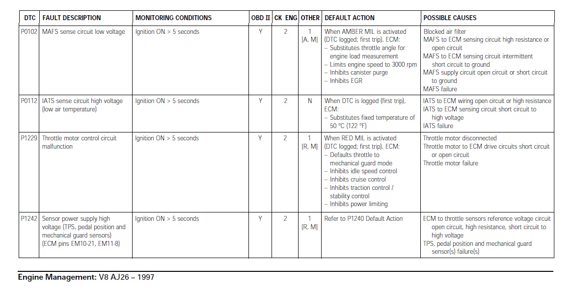

Here's the extract from the Jaguar DTC Listing for the codes you have found. The 'possible causes' gives more detail on what to check:

The codes indicate a throttle body problem. I am not well informed on that subject, but the advise often given is to clean the contacts of the connectors to the throttle body first.
