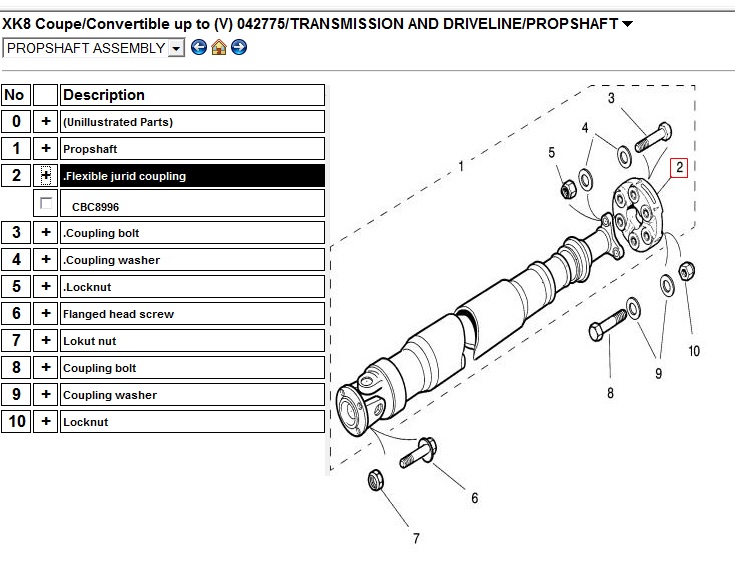

The first two things that come to mind with odd clunks from beneath the car are prop shaft and exhaust.
Check the prop shaft UJ bolts for tightness at both ends and the Jurid coupling (item 2) for degradation:

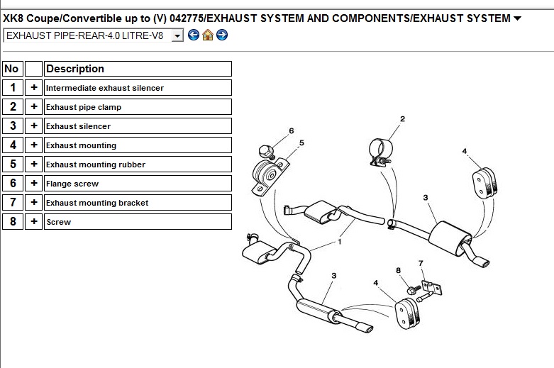

On the exhaust system, apart from loose heat shields, check the rubber hangers (items 4 and 5):
If these split, then metal to metal contact can create odd clunks.

As Graham says it sounds to me like an exhaust mounting bush.
