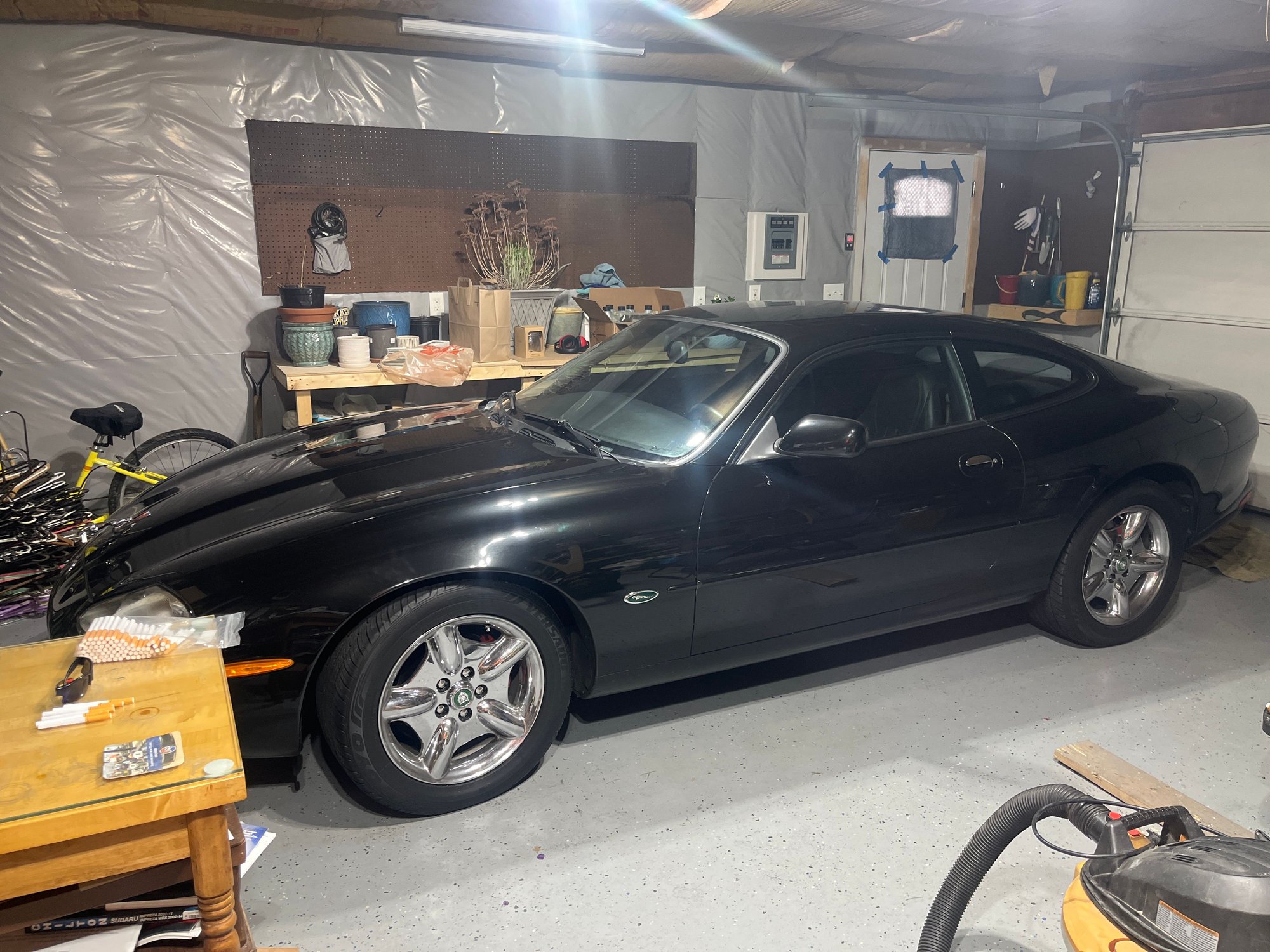

Hey guys so winter is over here and weather is getting to the point of being decent enough to start more xk8 projects(yay!!) two big port coming up are transmission oil and filter change, and then it’s on to new shocks and bushings all around. Let’s focus on the first one for now:
so last year I bought a kit to change the trans oil and filter, got a filter, pan gasket and 6liters of zf lifeguard, I then got the trans go pressure regulator valve repair kit as well based on advise from here, all of which is yet to be installed. My car has low miles, 69,000k so I’m doing this as preventative maintenance to avoid the dreaded drum failures as best as I can. It’s not an everyday driver either so I figured I’d start with the filter, pan gasket and fluid change, as well as the pressure regulator first, and see how it goes. Question is this, I remember when researching all this that the early xk8 trans oil pans had a smaller “headed” bolt verses the newer one, And heard/read/saw that they sometimes seize due to bing steel into aluminum. Anyone know the part number for the newer better ones, how many are needed and if they are direct replacements? Again I have 97 xk8 coupe with the zf 5hp trans, and based on all I’ve done so far to this car I would put any amount of money on that the trans fluid and filter have never been changed… I mean I changed out the “factory oem” fuel filter, did the timing chains and I still have the nikisil lined cylinder motor so yeah, trans is probably untouched as well. Thanks
