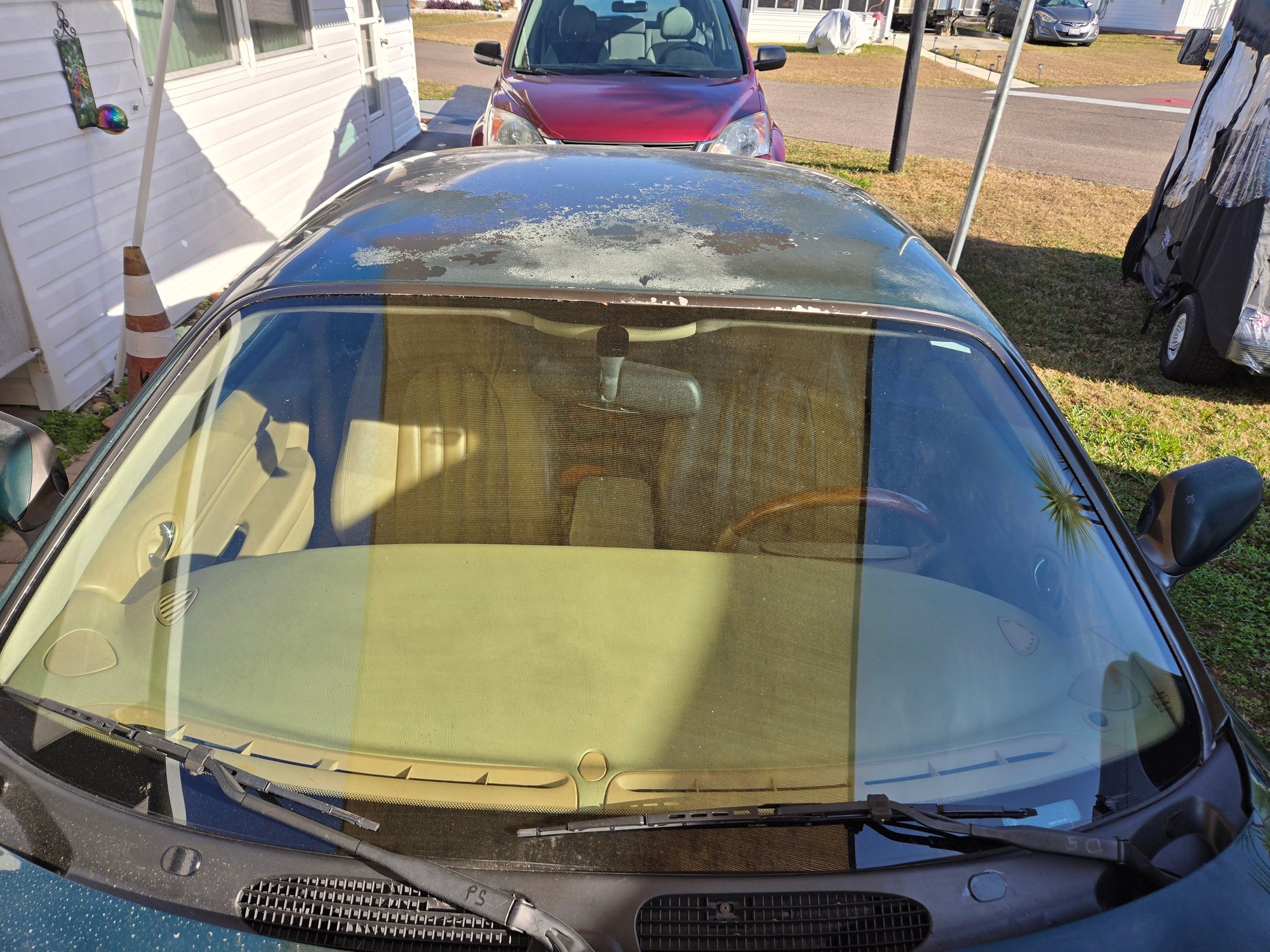

Default 97xk8 paint code for charcoal metallic moulding windshield drip rails etc. Mine are p
Hopefully there is a paint code for the metallic Grey moldings or some
Would like to do the mouldings before paint
thing close

Someone here will probably know the code, but... alternatives would be to take it to your local auto paint supply & they can shoot the trin & generate a formula, or... there are some spray-can wheel paints that are a very close match available at most any place that sells spray-can paint. Just make sure you thoroughly sand the parts down & use a good primer, & sand that before painting. Otherwise, the paint may pull off when you tape it to paint the car.

Dorchester Gray, I used a rattle can from Walmart, a perfect match.
https://www.walmart.com/ip/for-Jaguar-DORCHESTER-GRAY-METALLIC-342-Paint-My-Ride-Single-Stage-EZspray-Aerosol/9808922540?classType=REGULAR&from=/search
P
aint Code is 342/LDP

At a paint shop, they can measure the color with a colorimeter and mix the paint with near-perfect accuracy. You also need clear coat and proper surface preparation with the right abrasives, etc. (the list goes on, including a paint booth). But it is possible to paint it yourself; however, it won't be the same as a paint workshop. I took my XK8 to a paint workshop for a few imperfections; it's a task I haven't yet dared to attempt (yet). I have completed a course in automotive painting and I know that it is a complex task involving skill and technical equipment. However, in some places it is possible for the public to rent a paint booth by the hour to do this work ourselves.
