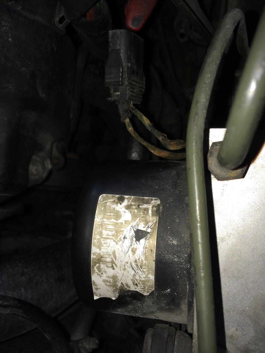

Curious as to what happened here. Can you tell us if you did replace the motor?
I have a 97 that was brought to me with abs traction control warnings in the screen and a code for the abs pump.
The module is unopened.
The wires from the motor to the plug have lost all insulation and I am afraid they probably shorted out.
The label on the motor has no visible numbering left.
Question. Are all the motors the same and can they be switched out?
I have a pump from a 98 available.
Both abs pumps do have the same module number.
Both are 5 line units. Damaged one from a 97 the other from a 98, the 98 module has been opened and resealed.

Not a pretty sight. <br/>Surprisingly fuse #16, #18 and #04 on left engine compartment are not blown.

My wires have also lost all insulation. Were you able to remove the wire from the harness connection and the motor connection? Thank you
