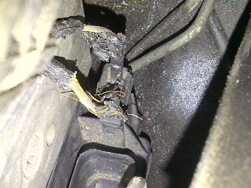

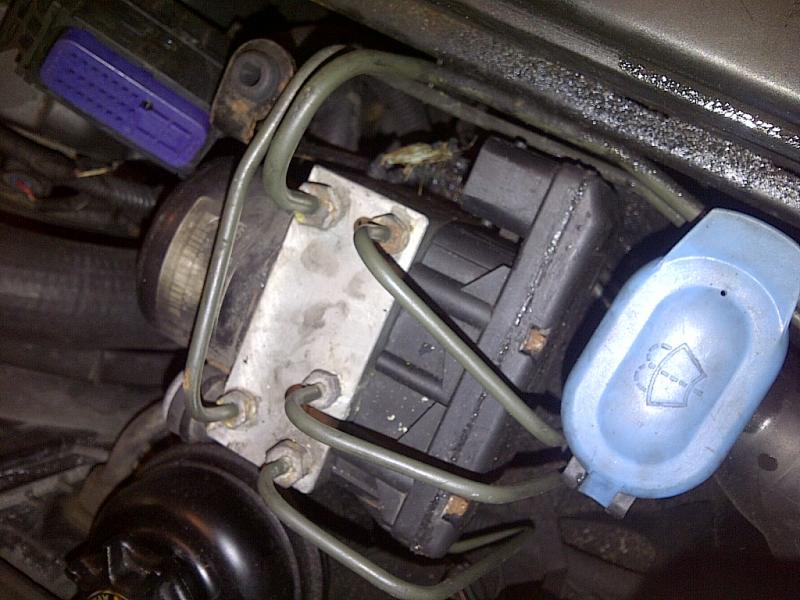

After further investigation, I found the source of this battery out of voltage error code and "Stability Control Fail." It turns out that somehow the two wires near the ABS controller must have shorted out, so the metal wires were actually touching. I cleaned the wires, resealed them, and started the car up, the ABS voltage error was all fixed, no more code. I didn't even have to clear the code.
I have driven about 3,000 miles since this repair, with no issues or codes. Here are pictures of the exposed wires that were the culprit.

The simple ones feel the best when you track them down.

Thanks ever so for reporting back with the correction. We can never over stress, powers and grounds, powers and grounds.
Mighty glad the issue could be taken care of without major expense. We like simple!!
