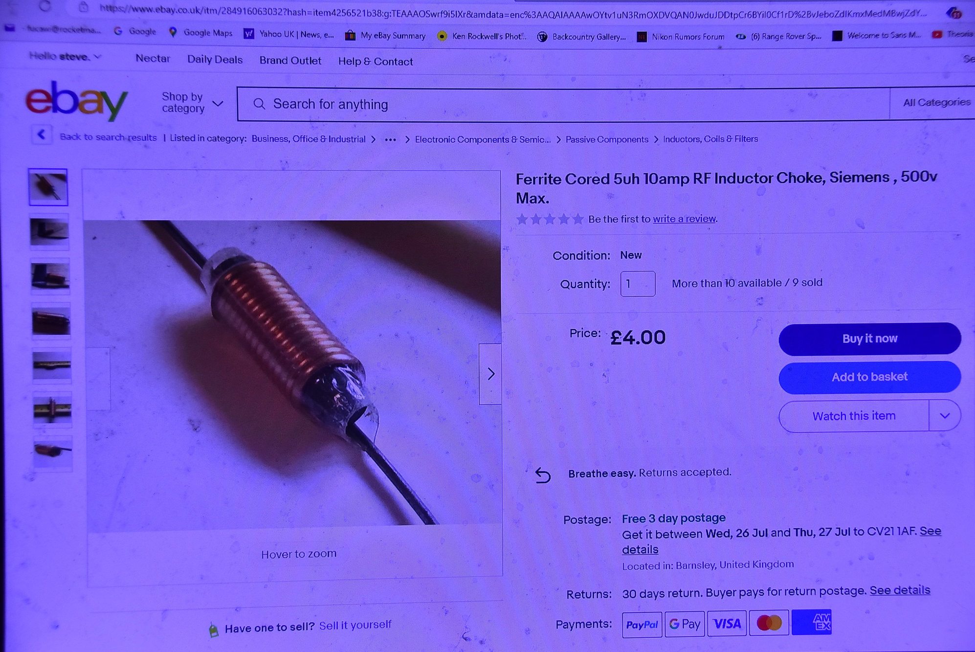

Can yo describe the sound or do a video. If its a whine varies with engine speed suspect alternator . Try a capacitor traditionally 3 uf from each 12v line to earth or and a choke in the cable. Or clamp one of those inductors onto it you get on USB cable .
If you have an antenna try disconnecting that.
