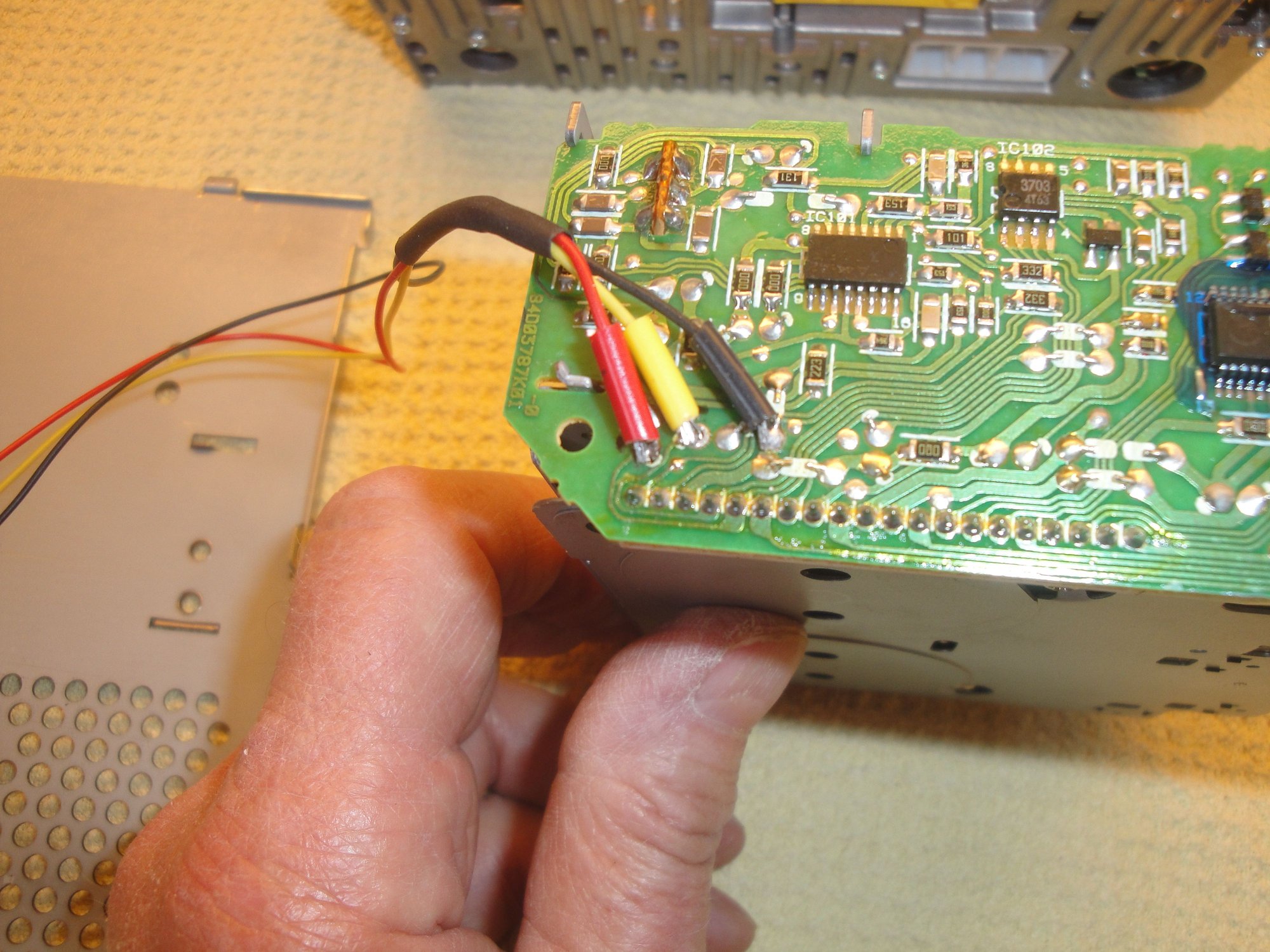

Here's a link that might help you, depending on which make of cassette radio your XK8 has.
www.jaguarforum.com/showthread.php?t=57182
Also a photo of how I connected mine in my 2005 XK8. It's an Alpine system. Black wire is Ground, Red and Yellow are Left and Right Lines In. I soldered them where they are for convenience, but the come off Pins 3, 4 and 5 from the left, counting along that row of 20 solder points.

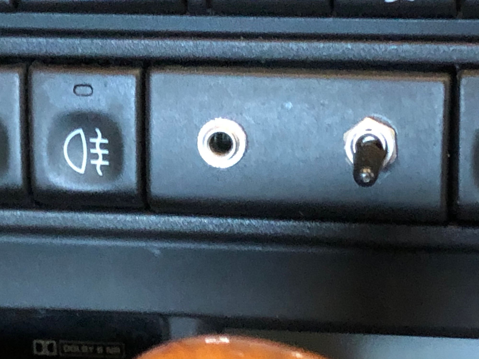

I had a car radio technician hard wire an aux input to factory head unit. We used a blank seat heater switch plate to install the input with small micro switch to select Aux or AM/FM/Cassette/CD Changer. Allows me to use anything with 3.5 “ jack iPhone, iPod etc. Working great for 10 years now.

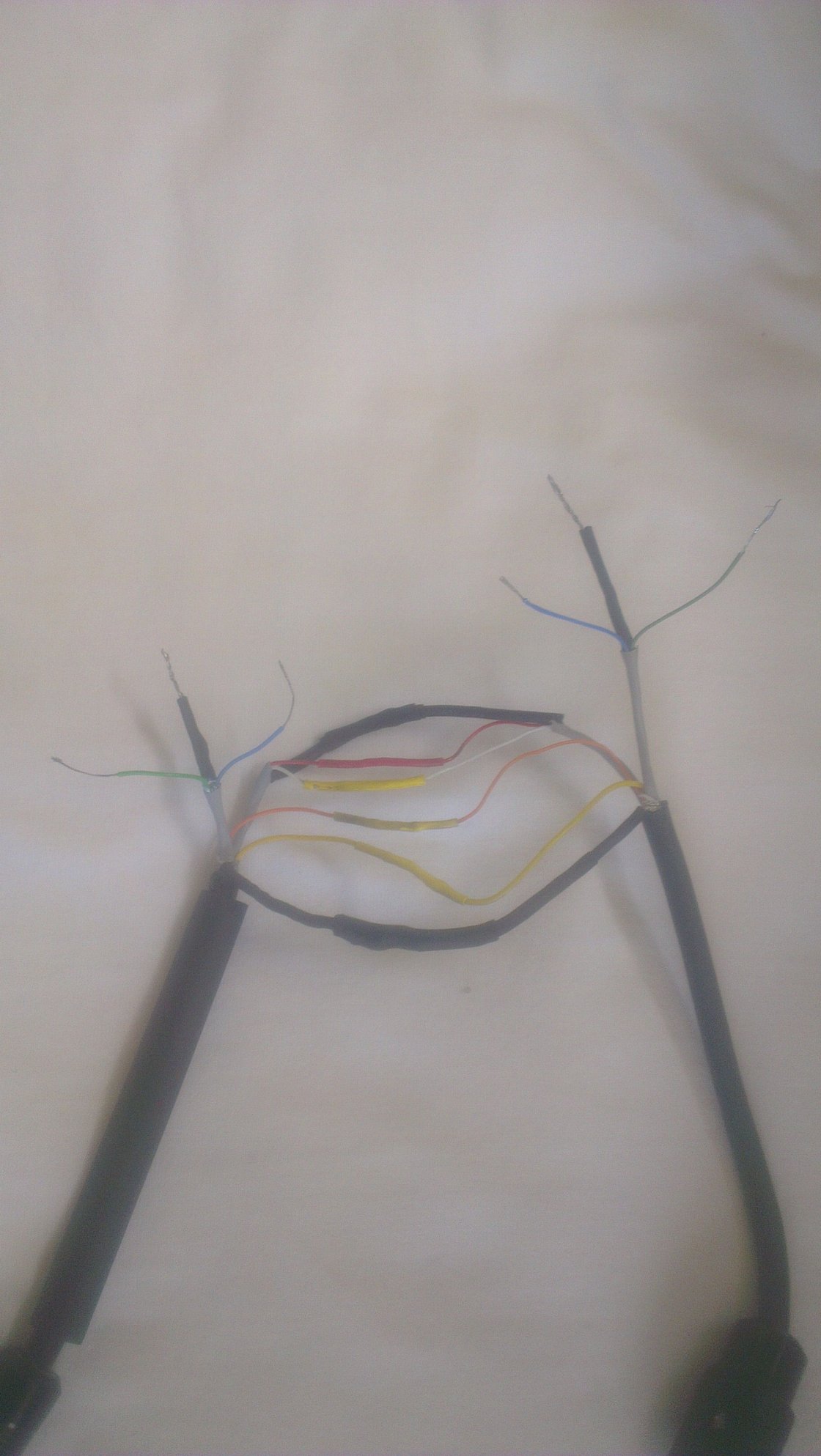

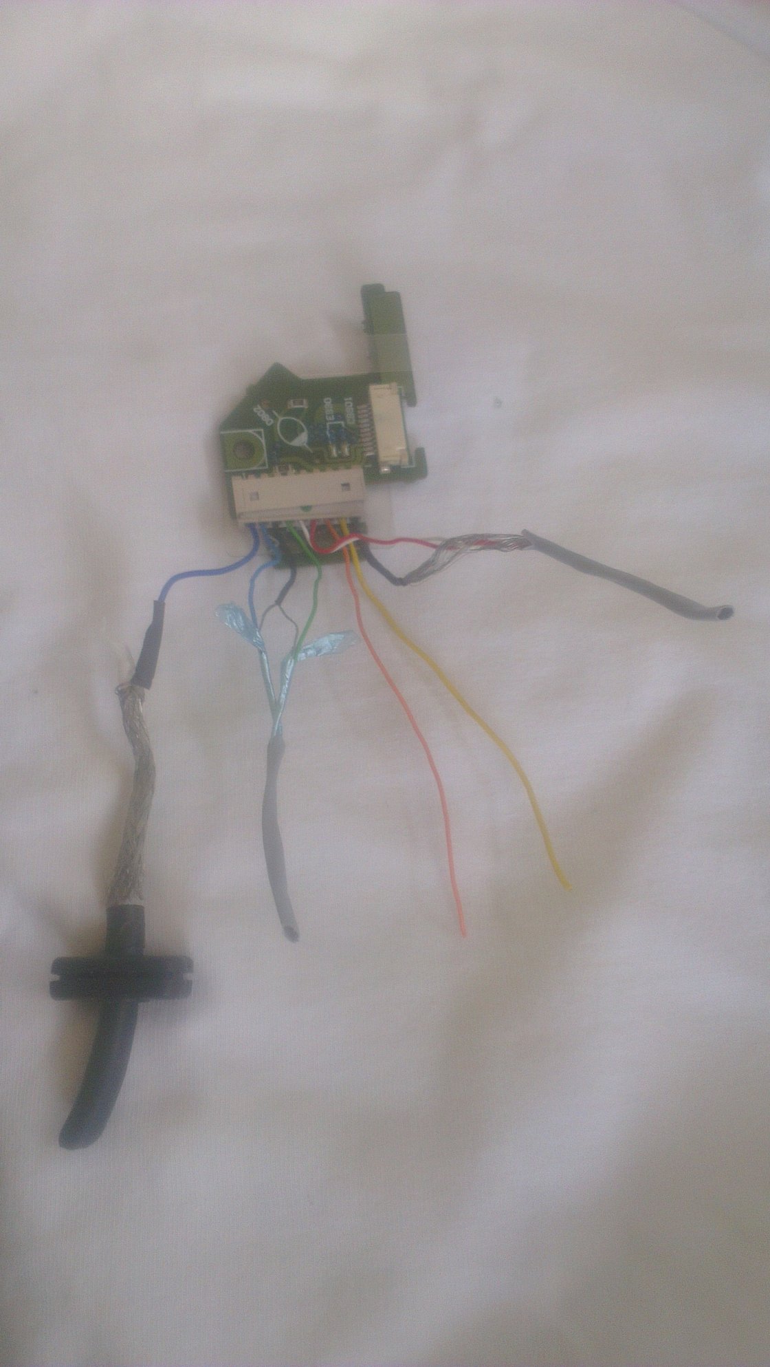

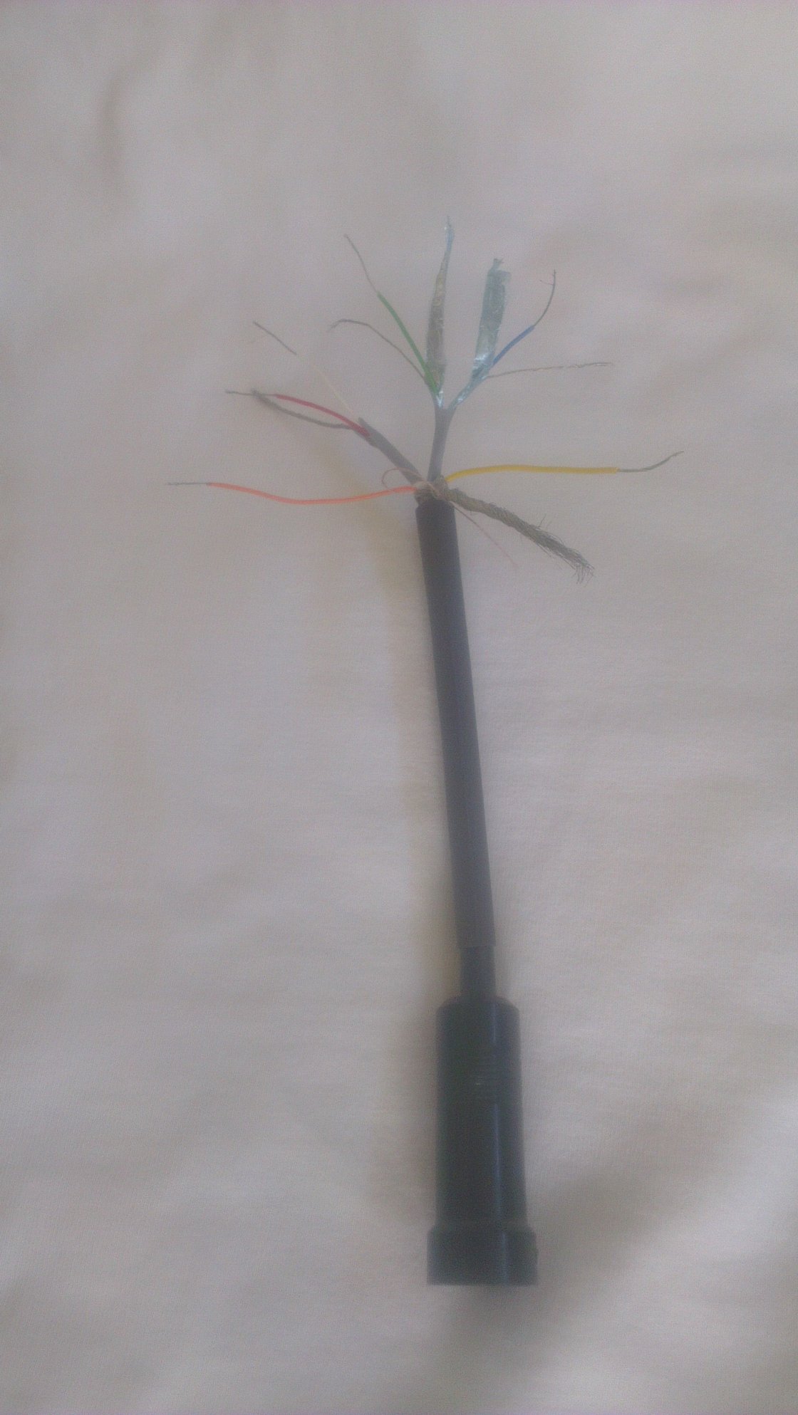

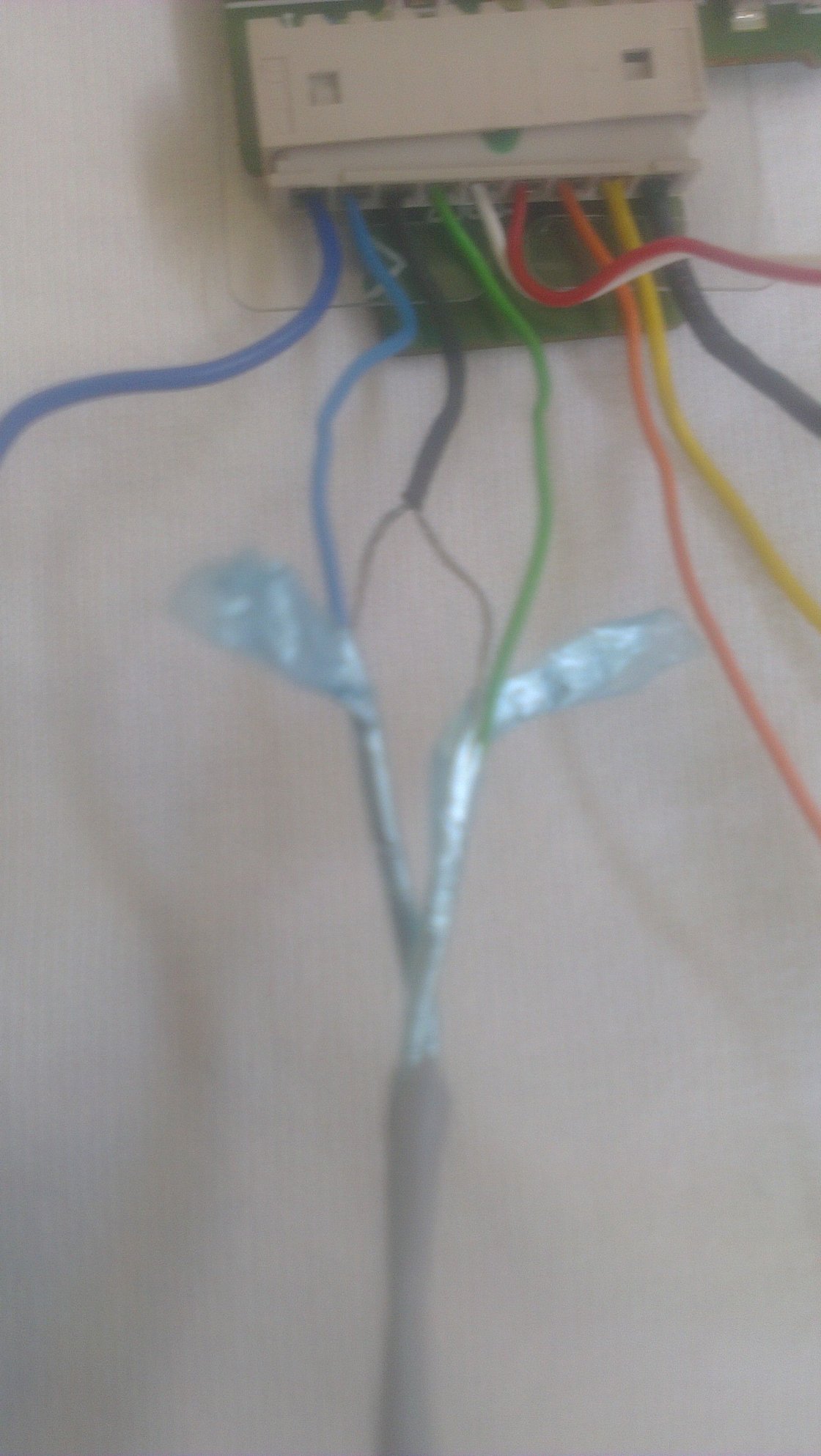

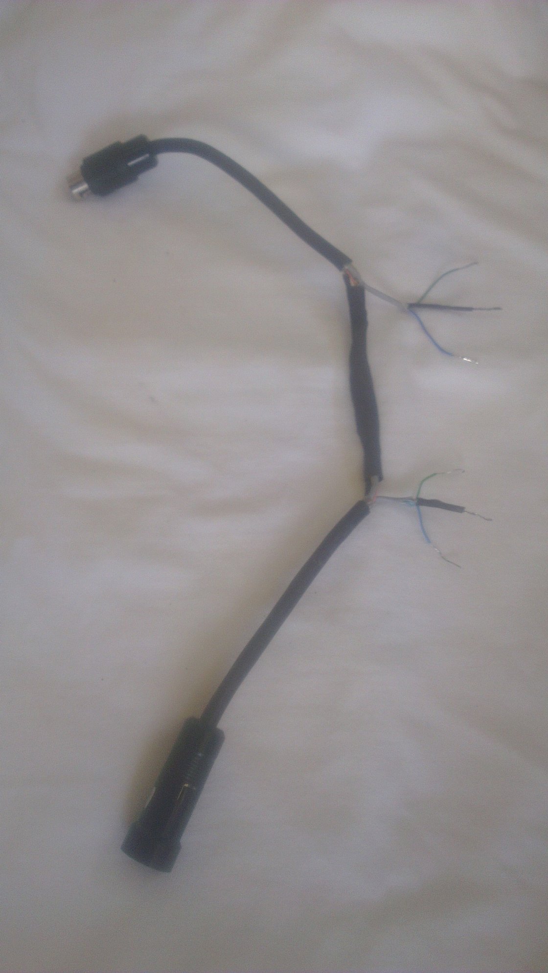

I have the alpine boot CD changer and im on with an al-net extension cable splice. (when i have time!)
Iv an old cd changer and i cut off the pig tail (female) and got a male extension from ebay, using both to make the extension splice.
This way, (once made) you dont need to open any thing up to solder wire's to anything.
May not be the way you want to go, but some photos that may help you, or others.
Thats as far as i got with the extension cable splice..
I will do a full write up when its all done (no time right now to finish this project)........

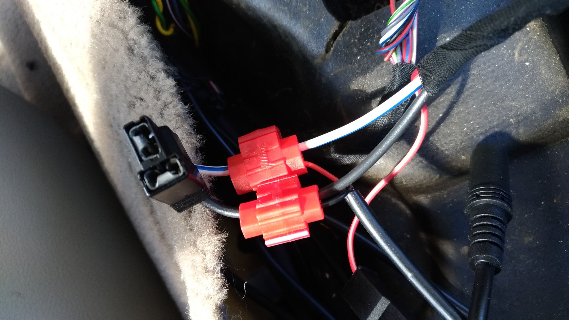

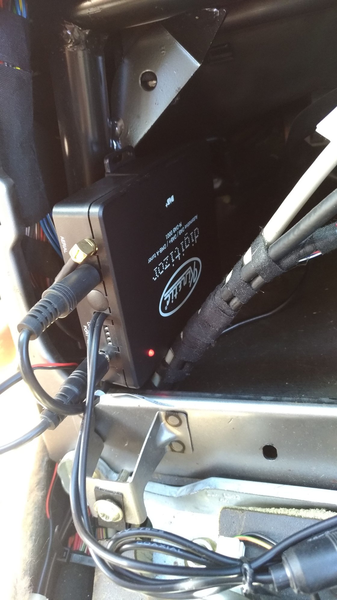

Ok, did mount the kit, all went well(for once, wish I could say the same for the new headiner...), sound quality then? not to bad at all, haven't tried switching(with same audio on both) btw aux/CD just yet but I'd say CD is better, so happy with the result, did not fiddle around with the DAB stuff(did hook up a DAB arial though), no point really since DAB is only available at the moment in big city regions here in Sweden.
recall a member asking for how to connect the wiring, here are a few pics, basically power spliced into the cig lighter wiring(if key is out so is power to the DAB unit), and cables tucked in at left side of carpet, DAB antenna mounted at right rear window
Cheers!
DAB unit going into/behind head unit, I tucked away in there to the left(car is LHD)
black is earth, red to blue/white(+) on the cig power connector,

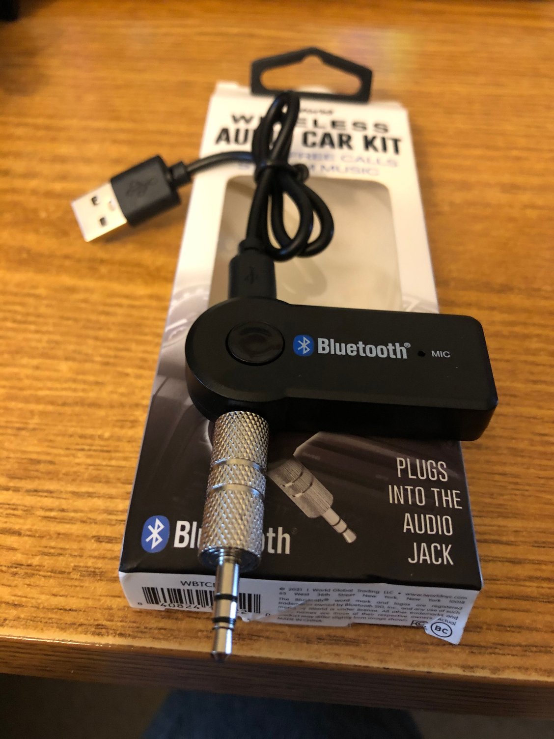

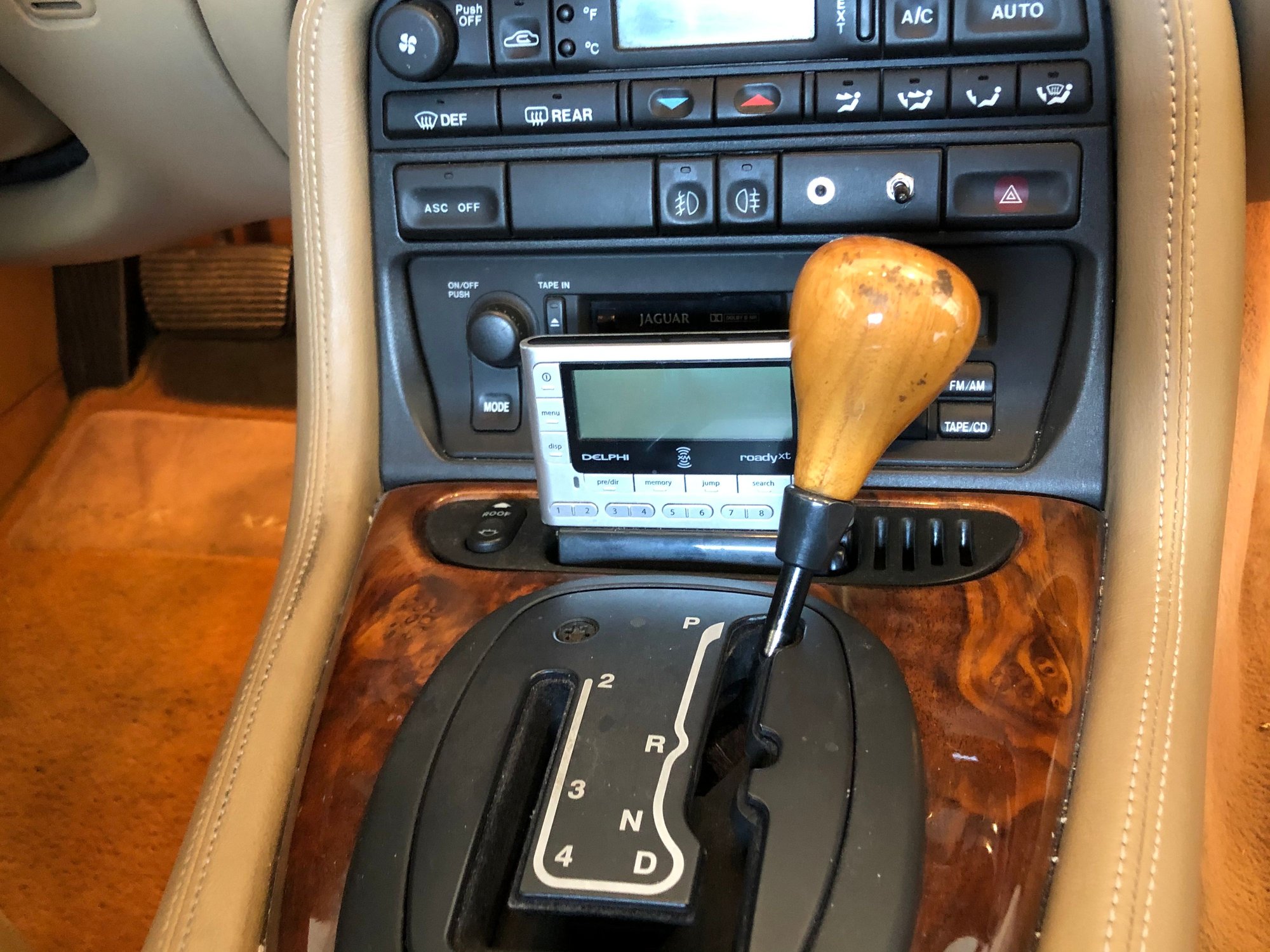

Default Bluetooth For Under $10
Just picked this up at WalMart, it was by the checkout stand and works pretty good for streaming from your phone and more importantly making calls. $8.99 with charging cable.
