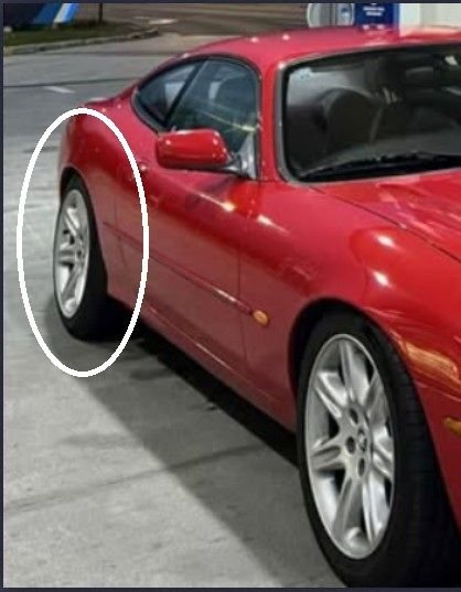

A few observations
  • PO somewhere along the line was more interested in appearance than maintenance
  • The front shock mounts are shot
  • Unless it's had an older front bumper fitted, it's older than MY2002. The VIN will tell you
Camber looks wrong
and +1 on all the above replies
Bottom line: Its value is so far away from what the owner wants, I doubt you could reach an agreement. It's about €8-9,000 overpriced IMO as it stands.

Those look to me like AI photos, which is why the camber looks odd, but the whole car looks not quite right. Any chance this is a scam seller?
Old Feb 10, 2026 | 07:46 AM
addictedtopain's Avatar
Joined: Feb 2026
Posts: 18
Likes: 6
I think they just used some AI editor to blur the plates (it's not like I can do much with the plate number anyway) and all of the pictures are taken from a strange angle.
There was also https://pasteboard.co/GKaaPxFP3gBZ.png and https://pasteboard.co/1SfLvDxaHEiT.png which don't look like they have any AI applied to them. The owner is a real person, I talked to them on the phone and they agreed to let me see the car in person so I'll be able to verify that at least
re camber, it looks like the car is on lowered springs, to me it looks lower than other stock XK8 vehicles.
Another strange thing is, the registration certificate says it has a 4.2, but the engine definitely doesn't look like a 4.2, and the VIN code ends with A28049. Based on https://www.jaguarforums.com/forum/x...-dates-193888/ it indeed is a 2002 model, but a 4.0. My best guess is, someone made a mistake when the car was registered first time in the country. Owner said it's not an import, I could probably verify that with VIN but I don't want to spend my money on a carfax just yet.
