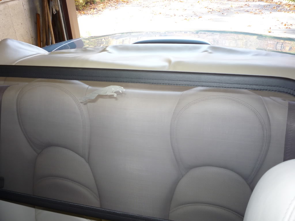

Bill,
Nice picture--especially like the wheels

I installed my deflector the recommended way and find that it looks OK sitting up a little higher. It also seems to deflect more wind that way. The top of the deflector is well above seeing it in my rear view mirror. I think I will keep it this way.
Bill N
03 XKR
