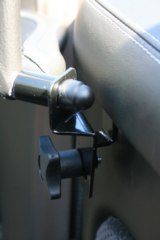

Mounted mine 2 weeks ago, and it does stand straight. Did you properly tighten the bolts on each side? Here are some pics:
BTW, instructions are here: http://www.welshent.com/guides/pdf/x...structions.pdf . Also useful to know that what the instructions call driver side is the right side :-)
On this note, did you guys notice that there is a speaker on the leather mounting on the right side, but not on the left side? Would make sense to have it on the left for us yankees...

Got mine installed today, not road-tested yet bu I feel good about it.
The answer to the Q I posed about the plastic washers is, you use them on the lower threaded portion of the upright deflector.
The are place as such:
L sleeve/bracket > plastic washer > lower angle bracket > plastic washer > Nylock nut.
This allows you to be able to tighten those nuts enough so you can have the upper vertical defector vertical (not relying on the lower deflector) while still allowing for movement as needed.
Seismic, I think this is the answer to your Q.
PS: Yes I did test fit the upper bracket, but I was 99% sure of where to place it.
I simply cut a piece of paper that matched the pre-drilled side. (No I didn;t get the cut off corner, all I needed was the back and inside edge).
Noted the holes on the predrilled side.
Now simply flip over and overlay on the non-predrilled side and mark.
Worked like a dream.
