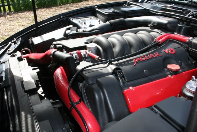

I went to your web sight and found some very interesting pics. I was wondering if there is some back sorry and details to the jag motor with the velocity stacks. I have a 4.2L non "R" and would love to do something like that with my car.
As my research continues to find out what I can do or would like to do, I realize there aren't all to many options for me. I'm hopping you at least have hoses and engine nick
nacks that I can use to dress up my engine bay. It is more of a show car that I'm looking for. So I would like to do some things like remove all the excess baggage if possible. Abs, custom intake and air box, bigger aftermarket radiator, aluminum coolant over flow, aluminum fuel rails, and I would really like to run an inline thermostat housing and get rid of that ugly crappy plastic one. I might get rid of the A/C and heater.
Do you have any advice or anything to help me in this endeavor?

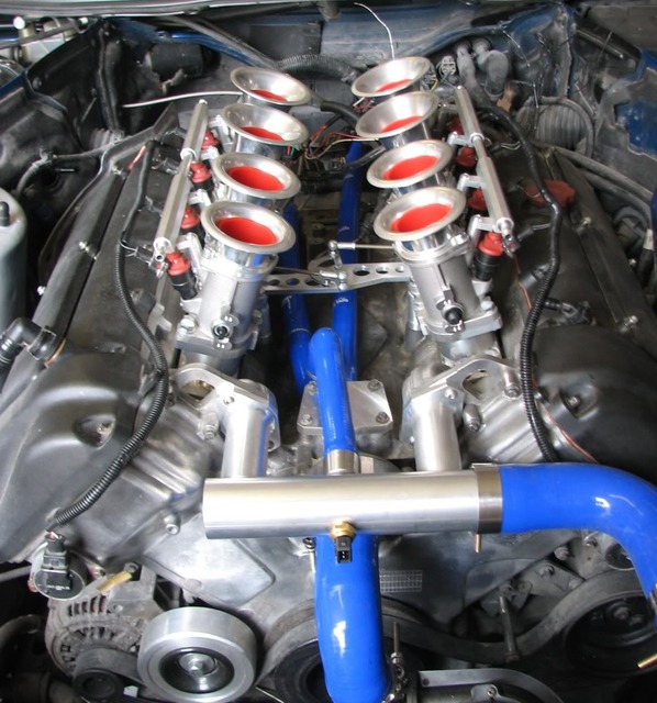

The engine you are refering to is my track car which also has a 6 speed manual attached to it.
I made the inlet manifolds myself to attached the 8 throttle bodies, larger injectors, lost the thermostat and water pump which was replaced with a digitally controlled Davies Craig, radiator is from an EVO with pacet fans....
Not a cheap setup, theres about $10K of just parts there let alone the time to fit everything not forgetting all the ongoing R&D work that has to be done if something is not right.
The engine runs off a Emerald K3 ECU which is a stand alone system, this also has the capability of holding up to 3 different maps which can be changed whilst on the move at the flick of a switch, something that would be very handy in a road car!
Getting back into the normal world, I can do hoses, I cant see why you couldn't fabricate a different manifold if you wanted to and all the usual bling you can also do...

That is great! I'm just glad it can be done. I've been wanting to do everything to my car that you have done to yours. Stacks, manual trans, and all on a non supper charged 4.2L. I understand yours is on a track car so you have none of the creature comforts and that is due to the stand alone.
