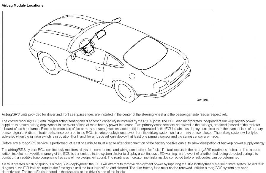

My 1999 xk8 that I just bought was previously in a front end wreck, and the air bags were (supposedly) replaced.
The air bag light in the dash is on, so I'm thinking about replacing the air bag module with one from another xk8 (2001).
Does anyone know where the air bag module is located?

my JTIS shows they are located behind each airbag unit themselves...steering wheel and glove box
