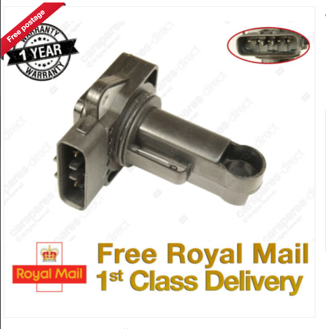

Thanks for the replies. Mine is a '97 XK8 with a one piece MAF sensor, rather than the later type drop in sensor.
Mine is liker the first image, but I am wondering if I can use the one in the second image, with the later airbag of course.
thanks,
Current MAF Sensor
Later (cheaper) MAF Sensor

Short answer is NO. Take a look at your existing and the replacement you are considering. You don't have the extra 2 wires the replacement needs to work.
