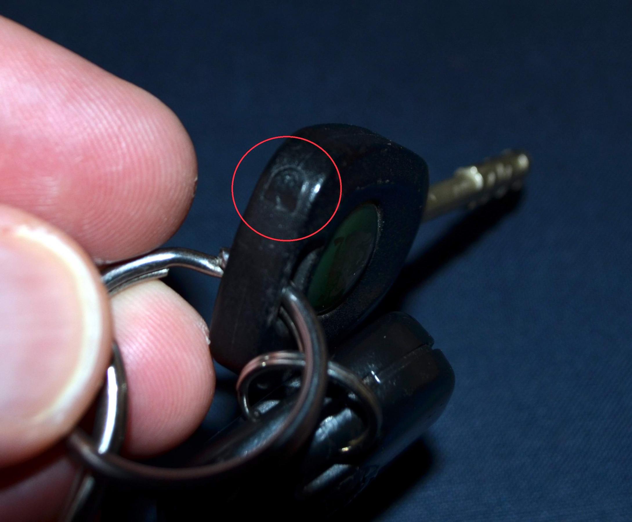

The transponder chip is embedded in the key head (beneath the small cover circled in red):
It pairs with the Transponder Coil (a.k.a. the 'exciter ring' - item 8) on the ignition lock to allow the vehicle to be started.
