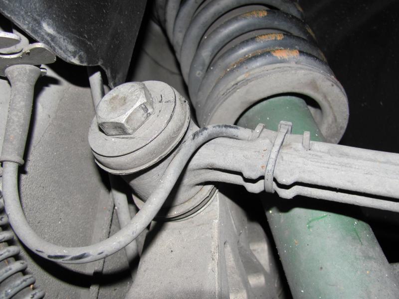

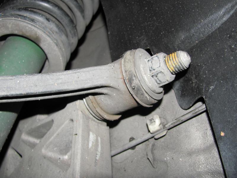

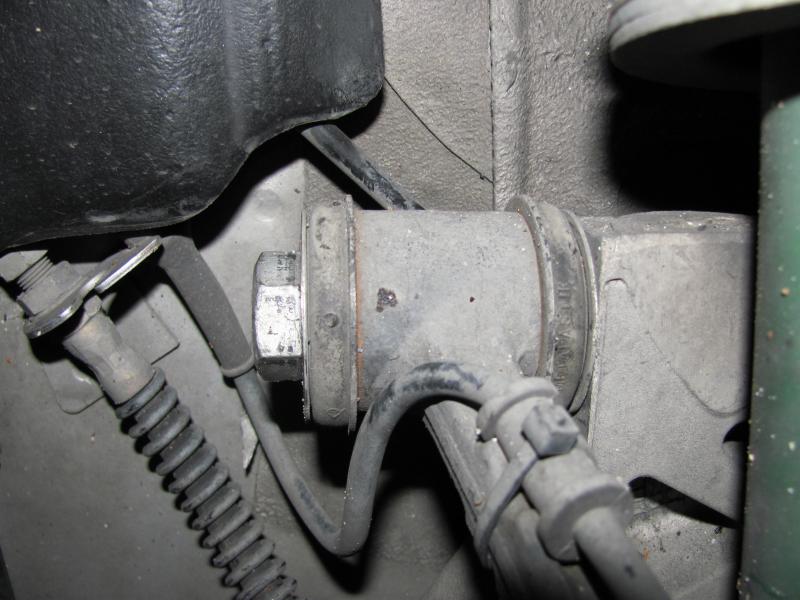

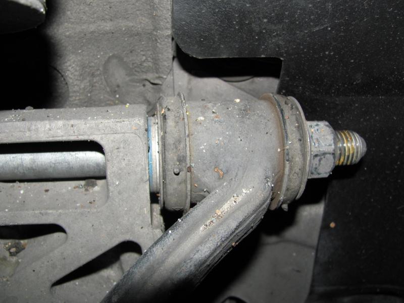

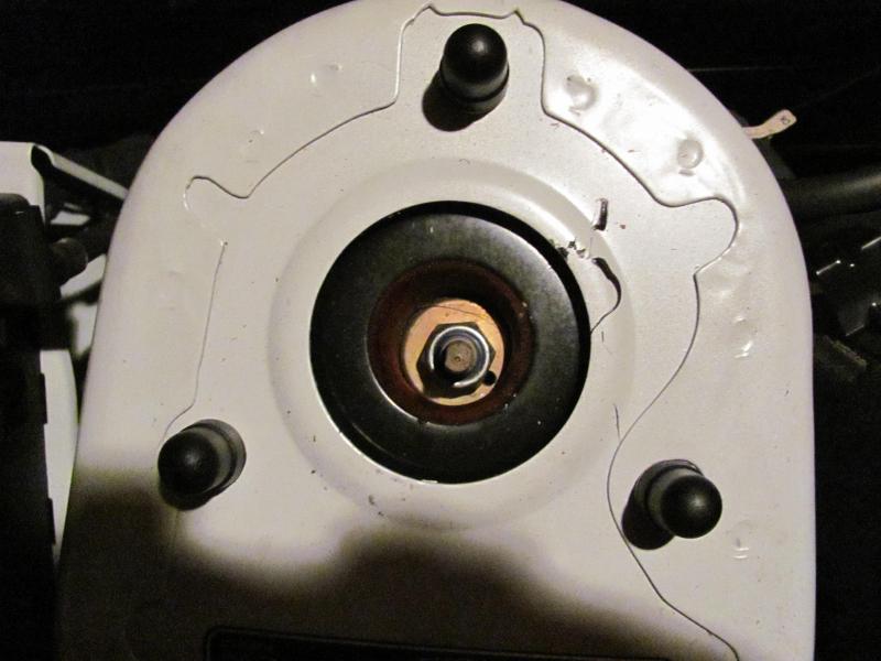

I pulled the left wheel off and took these.
Off center shock stud entering mount bracket....
Forward upper control arm bushings from the top...
Rear bushings from top...
View from underneath of the forward one...
And the other one..
Bushings themselves look ok to me, Bill, but I'm no expert. I do see some brown around them, is that the rust? No clunks from them, all the clunks were from the sway bar. Look ok to you?

Theyre fine as far as not the rust staining im talking about. But have them check for play once the ball joint is unbolted from the knuckle. Also can you shoot a pic of the upper shock mount at the outside of the top of the spring, not up in the center like that shot.
That's good news. I'll be sure to have them check it when everything else is getting done. Here's the left mount pic, the right is off center also, but not as much, barely noticable....

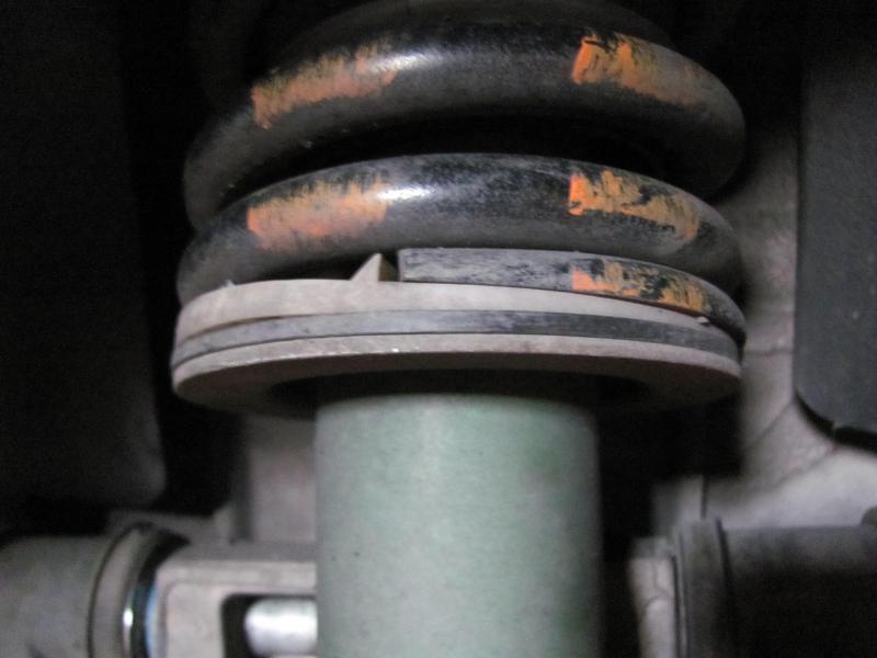

I was reffering to taking a pic up from the bottom inside the wheel arch area showing the mount ontop of the spring. You can readily see if the mount is collapsed from that point. You had taken a good pic from the bottom, but only the center of the mount where the shock goes into it. If you pan out and get the outer most top of the coil where it seats against the mount

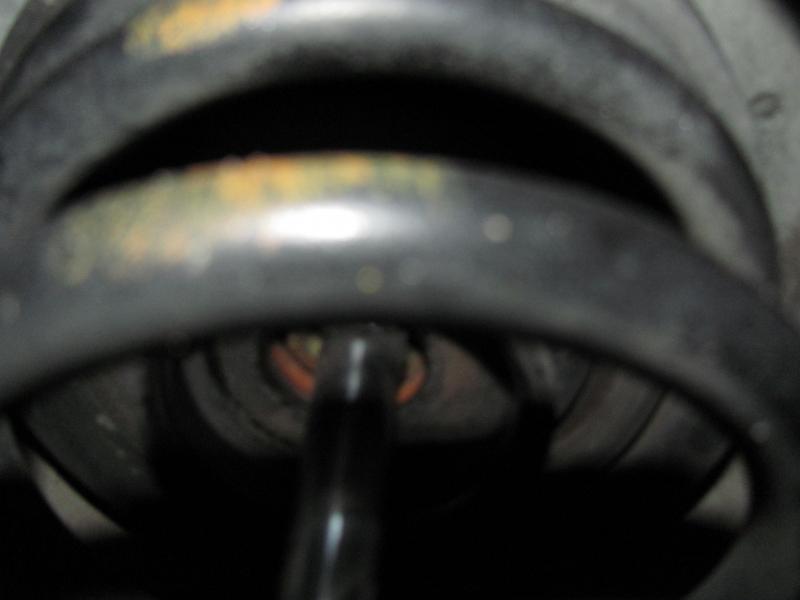

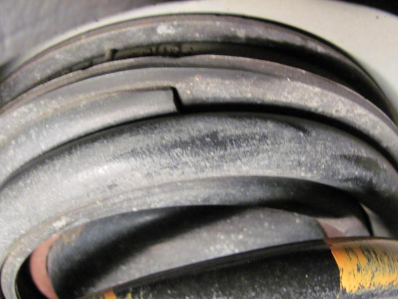

OK, here you go...Also wondering how the lower spring support looks...seems ok...
Attached Thumbnails Alignment Issues-upper-shock-003.jpg   Alignment Issues-upper-shock-004.jpg
Old Dec 24, 2011 | 09:18 AM
  #32
Brutal's Avatar
Joined: Sep 2008
Posts: 7,255
Likes: 2,209
From: Damon /Houston, Texas
lol, your upper mounts are GONE, Theres almost nothing left. Wait till you compare the new to old. Thaat is your camber and ride height issue right there. I would also venture to say your can see where the tires have been hitting in the top of the wheel arch liners when hitting bumps and potholes. you tech should have been replacing these instead of a bandaid eccentrics. but youll have alittle adjustabilty in the front now
