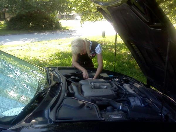

She's a goober. She loves doing the whole "Nerdy Jaguar girl" deal
She was the reason why I got the XJR, which after it got totaled I got the XKR. So I had to repay the favor and bought her this XJ6. It saved her life when someone T-boned her.
BTW, doesn't the XKR coupe not come with that strut tower brace? I dont see that bar that connects from the shock tower bolt to the cowl area.
