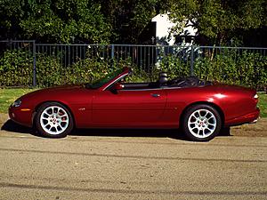

As others have said, if you replace the plastic tensioners on the 4.0L motors, you should be fine with a 4.0 if the price warrants it. The Mercedes 5spd trans seems to be the stoutest, least worrisome trans in any of the X100 iterations, and that only came in the 4.0L XKR. My 2002 4.0L XKR is now undergoing a complete restoration where I am spending more than what I paid for the car a 175,000 miles ago. I love that car even though my X150 XKR coupe drives so much better. There is a grand feeling driving the X100 and for me a closer link to Jaguar's heritage. And it's arguably the most sensual body style since the E-type. Don't be afraid of either the 4.2 or the 4.0 so long as regular maintenance was done throughout and so long as the rest of the car is in the condition you expect.
