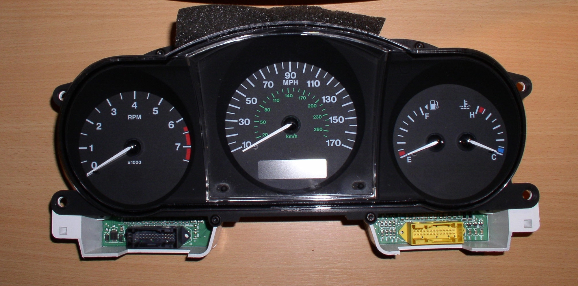

Any chance the water found its way along the harness to the Instrument Pack?
The right hand harness connection leads in from where you've had water ingress.

Take a look at the ECU and see if there was water there, but I would agree with Graham that the instrument pack or one or more of the connectors to it are at fault. Fortunately, there are rebuild services for that.

Thanks to you who replied and tried to be of assistance, I have resolved the issue of the warning lights, I replaced the complete major instrument cluster with a known good one and hey presto all works I am however left with a mileage showing nearly twice as much as the car has genuinely done, is there a way to calibrate to the original mileage or get the old cluster repaired?
