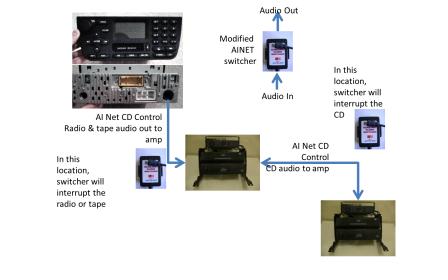

While this does not include the Nav option, it may help some understand the differences in sound source locations after using the modified AINET switcher.
Alpine Ainet/Aux RCA input switcher not working: 2000 XK8 Premium Sound-ainet-switcher.jpg
