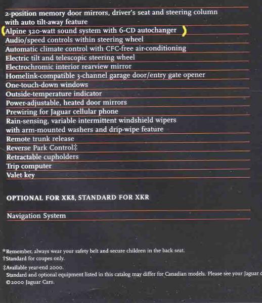

Premium Audio has been standard on all U.S. XKRs. and all U.S. XK8s since 2000
Note: MY 2000 U.S. XKRs had Nav as an option.
From the U.S. 2001 Brochure:

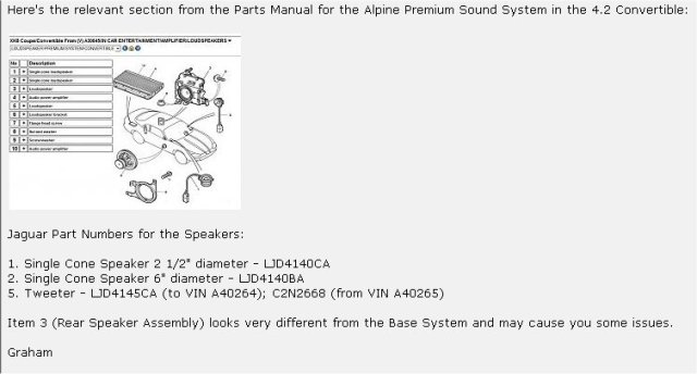

Here's the relevant section from the Parts Manual for the Alpine Premium Sound System in the 4.2 Convertible:
Jaguar Part Numbers for the Speakers:
1. Single Cone Speaker 2 1/2" diameter - LJD4140CA
2. Single Cone Speaker 6" diameter - LJD4140BA
5. Tweeter - LJD4145CA (to VIN A40264); C2N2668 (from VIN A40265)
Item 3 (Rear Speaker Assembly) looks very different from the Base System and may cause you some issues.

Alpine premium standard on all US XK8s Paul? I've got a US XK8 with the base audio system, which I want to desperately upgrade, and the six cd changer.
You're Right!!!
The 2000 U.S. Brochure does specify what they call a "Premium Audio System" as Standard on XK8.
But then, they go on to specify the Alpine 320 watt system with 6 CD Auto Changer as Optional.
However, starting in 2001, the Alpine System was indeed Standard on U.S. XK8s.
Sorry for the bad information.

If I decided to go down this route, item 3 will cause problems inasmuch it is not obvious where this piece of kit is situated....I have 2 woofer speakers in the 1/4 panels behind the front seats....I believe that in the coupe that it uses one central large woofer?
Item 3 definitely looks a more complex piece of kit than the others.

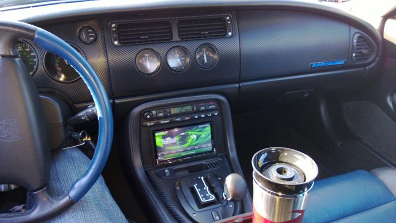

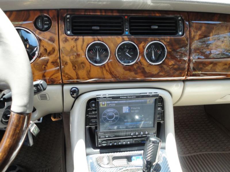

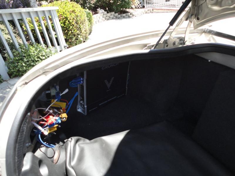

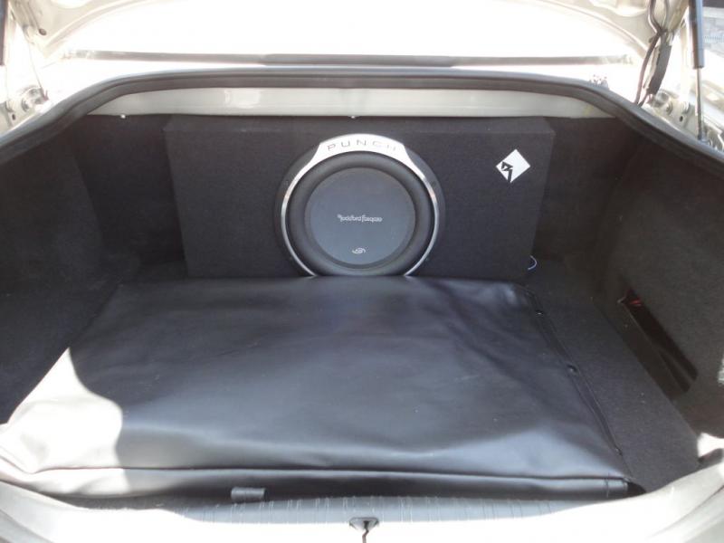

I had both an XK8 and an XKR upgraded. Realize that the Alpine has an optical link between the head unit and the amp (so I couldn't retain the amp). I went single DIN with a power up screen for the XK8 and double DIN for the XKR (had to relocate the second row of switches (heated seats etc.) into the glove box (which is a little annoying). The single DIN motorized screen required the car to be I drive to motor in and out and covered all the switches when deployed (a lot more annoying which is why I went double DIN the second time). On the XK8 went Pioneer matched set for the in door tweeter and mid-range, Kicker subs in the back (both were roadsters), for the XKR went Nexus speakers in the front (relocated the tweeters in the dash) and earthquake subs in the back. Used a Nexus amp in the XKR, don't recall what amp I used in the XK8. In both cases got upgraded navigation and satellite radio (and iPod/USB support). Swapped out the XKR nav for gauges. The biggest improvement in both cases was the subs, the Jag units are crap. In the XK8 I also tried a huge 12" sub in the trunk, wasn't worth the trouble (gas tank damps the sound). Here are some pictures.
Attached Thumbnails Alpine Premium Audio-dsc00636.jpg   Alpine Premium Audio-dsc00637.jpg   Alpine Premium Audio-dsc00638.jpg   Alpine Premium Audio-dsc00639.jpg   Alpine Premium Audio-p1000408.jpg
