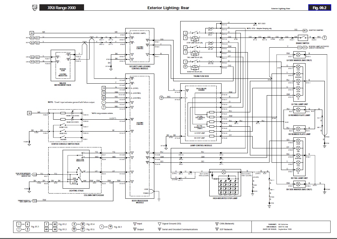

With only one side blowing, it's most likely a short. I'd start at the tail lamp unit and work forwards.
Here's the schematic for the rear exterior lighting:

GGG,
thanks! i'll give it a go. i believe the Jaguar Gods are starting me off with a basic problem as an initiation.
