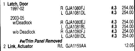

The car's battery is good and the car is otherwise healthy. Does this sound like a problem with the door latch mechanism (#1 in the diagram) ? Or with the control module (#5 in the diagram), which I think it also in the door ?
