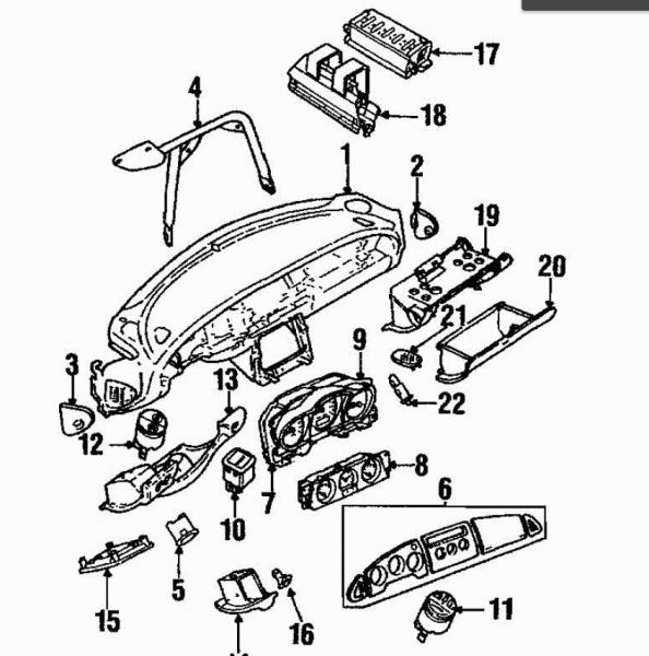

I was looking through parts diagrams to see what might be behind and/or below the dash and found this figure. Item 4 is something called instrument panel brace and I wonder if this piece is loose.
Does anyone know how to get to this brace?
Thanks,
Doug

My vote is on this brace. It meets all the symptoms you discribe: Under the dash, caused by wheel motion, etc.

That seems to be the obvious culprit but I just assumed that the braces would be noticeably loose and they are not. But I guess I will try to remove the cowl and take a look.
By the way, what about the brace for the instrument panel that I asked about and showed a figure of in a previous post?
Doug

Doug: Don't know about the dash brace, but I would check and tighten the three top of the dash bolts under the left and right 'shark fin' grills, and the center pop off cover. Also be careful with the oval cowl finisher covers. The tabs on each end get brittle and can easily break off.
