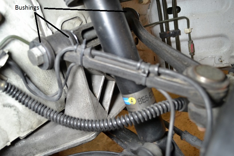

Do you guys have a photo or schematic sketch of exactly where those are? When I first brought the car in to the local mechanic for the sound, he replaced lower bushings (wishbone bushings?) and that did not help. I brought it back in and he claimed to look at everything suspension-wise and did not find anything obvious. So are the bushings you guys are talking about something that can be seen or discovered to be bad by grabbing things and jiggling or do you have to tear a bunch of stuff apart?
Thanks,
Doug

Default Upper A Arm Bushings
Look for deterioration of bushing first. Then with spring unloaded, ascertain the fit between the pivot bolt outside diameter and the aluminum subframe crossmember holes through which the bolt is inserted is a tight and solid fit. The bolt can wear an elliptical pattern in the crossmember.
Attached Thumbnails Another "what's that sound" thread-suspension.wheel.wells-7-1024x683-.jpg

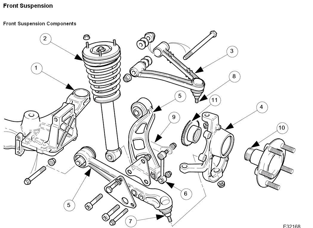

Hi,
Here is a diagram for you that may help with seeing the various bushes.
I had an experience with a knocking noise similar to yours, up on a ramp checked all the bushes etc... and everything seemed fine, however rather than just test the joints with a bar as you would normally, it's also worth pushing the outside of the actual bush to see if it's solid.
ie, when you test with a bar, often the leverage you can apply is not the same force as you get even at a low speed when driving and all can seem ok.
In my case the lower arm bushes were shot, when you pressed them with a screw driver directly on the outside , they simply collapsed, the outside of them looked fine but there was no bush left underneath .
It was frustrating and not until it reached a point of checking every bush extremely carefully did I find it.
XK's are sensitive and even more so if you have a convertible, I would say it's worth getting it up on a ramp again and re-checking because it does sound like a bush.
Best of luck....
