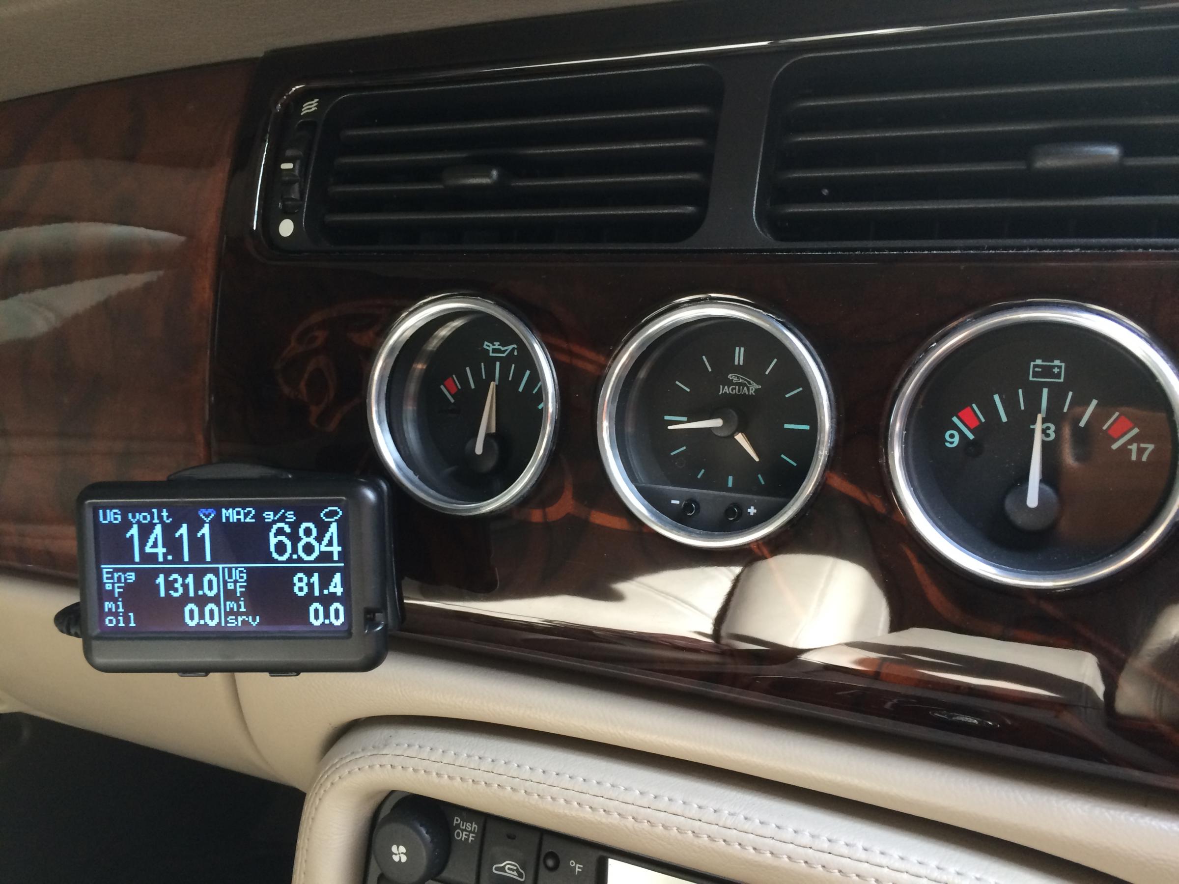

Well after reading this ancient thread and some other posts I took the plunge and bought UltraGuage EM 1.2 and I must say I'm pleased.
International delivery to UK was very fast (4 days) and there were no FedEx or customs charges to pay after i took the manufacturers' advice and registered for a personal FedEx account .
Setup was straight forward - scanning detected my 2001 XKR with 9141 protocol and a few dozen gauges were found as the manual described.
Only been in the car for a short while so now I see happy hours configuring and changing page settings but so far so good.
Steve

Hi Derek
Hit a "snag" this morning when had loads of warning lights and check engine light on with restricted performance - seems a common issue on the FAQ and down to non-strict OBD protocol use. Cleared all the issues and forced the ISO protocol as per manual so I'll see how it behaves on the way home. If still issues I'll get one of the specific ISO 9141 cutout cables they offer.
Also removed it from the centre dash panel as just doesn't look right so looking for an alternative place - will probably install in the centre coin tray adjacent to the soft top power button
Steve
Edit: Forcing the 9141 protocol and turning off auto page change has sorted all the issues with check engine light etc. Just driven 20 odd miles with no probs. I ordered one of the special cables anyway.
Yes, I really bought this for the engine/coolant temp gauge - seems to be pretty stable at 96*C (204*F) around town and in queues - briefly went up to 98*C (208*F) on fast dual carriageway but rapidly dropped back to 95 so all seems good. I have set the alarm at 110*C
