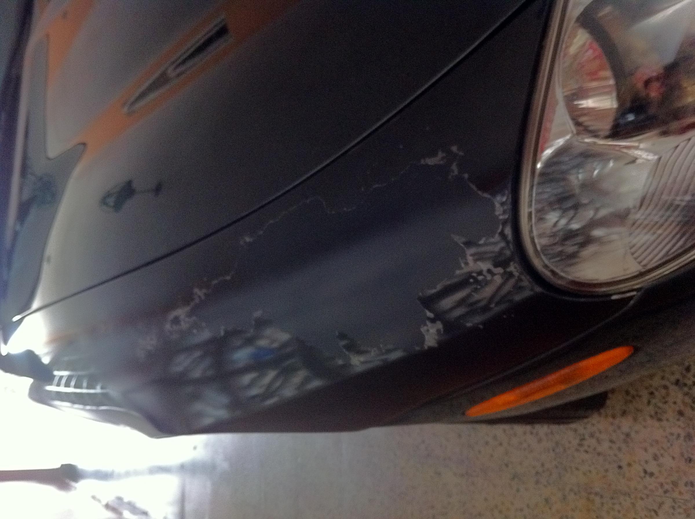

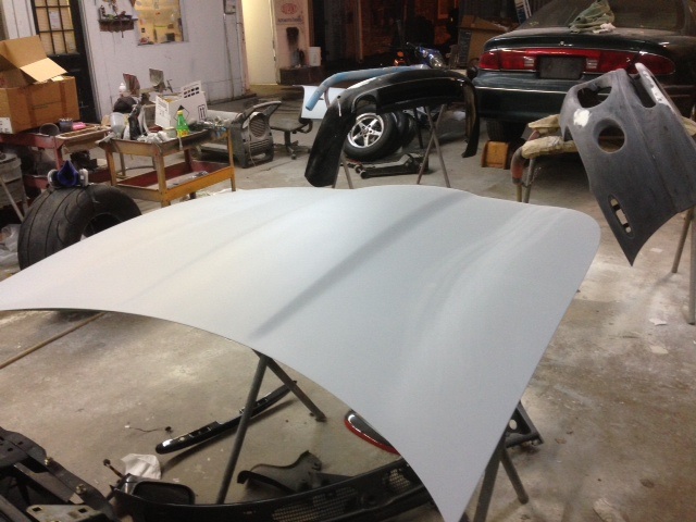

Just got back in town and what started out to be a re spray with some dent and ding repair and some crazing on the front fenders has turned into a nightmare!!
My body shop guy has found the crazing in several more spots. It was primarily on the front hood and fenders. But he also found it on the nose and boot lid.
It's now been totally taken to bare metal and new primer. $$$$$
What's the deal with the crazing. I had a 2002 X type a few years ago that had the exact same issue! And it was black too.
I'm wondering ho many other jaguars have the same issues.
On a good note, I saw the paint in person finally. A test piece. It's the richest black metallic I've ever seen. In the sun it looks like black diamonds and in the shade, it's just black. I think I chose well!!
A few pics in the process!! He's planning on having it finished next Wednesday. Anyone else having paint crazing on front? Paint job much bigger!!-image.jpg
Old Oct 24, 2013 | 03:30 PM
philhef's Avatar
Posts: 2,916
Likes: 547
From: North Carolina
Old Oct 24, 2013 | 03:31 PM
philhef's Avatar
Posts: 2,916
Likes: 547
philhef's Avatar
Posts: 2,916
Likes: 547
Old Oct 24, 2013 | 03:32 PM
philhef's Avatar
Posts: 2,916
Likes: 547
Had to post this so I could remember what I started with!! I miss my car!!!

Now this is starting to scare me guys. You're saying that crazing and cracking is due to bad previous repair work. So, I'm guessing my car went through a doozie... Ugh, I'd hate to think my car was involved in a big accident.
Phil, I've never seen a picture of your car where the paint looks bad, so I have to ask, what do you mean by crazing? Did it look like this?
Anyone else having paint crazing on front? Paint job much bigger!!-img_2653.jpg
Anyone else having paint crazing on front? Paint job much bigger!!-img_2655.jpg
This is the reason I never take pictures of the passenger side of my car. Now, my boot lid is starting to craze a little, but it hasn't lost the clear coat like in these pics. It just is starting to look like it has spider webs.
Attachment 59775
Attachment 59776
Nope, that's a clear coat failure. Much easier to deal with. Sort of. It can be sanded down to the color, then re painted. Mine looked like 1" hairs all over as if a dog shed on it. If I used black wax, it minimized the damage, but in the sun, it was visible. Mine was all the way down to the primer.
Believe me, those that have this issue know exactly what I'm talking about. I wish it was a clear coat failure.
This is what it looks like. If I used black wax, it filled cracks and only the sun showed the cracks. This pic is taken after washed, still wet, no wax.

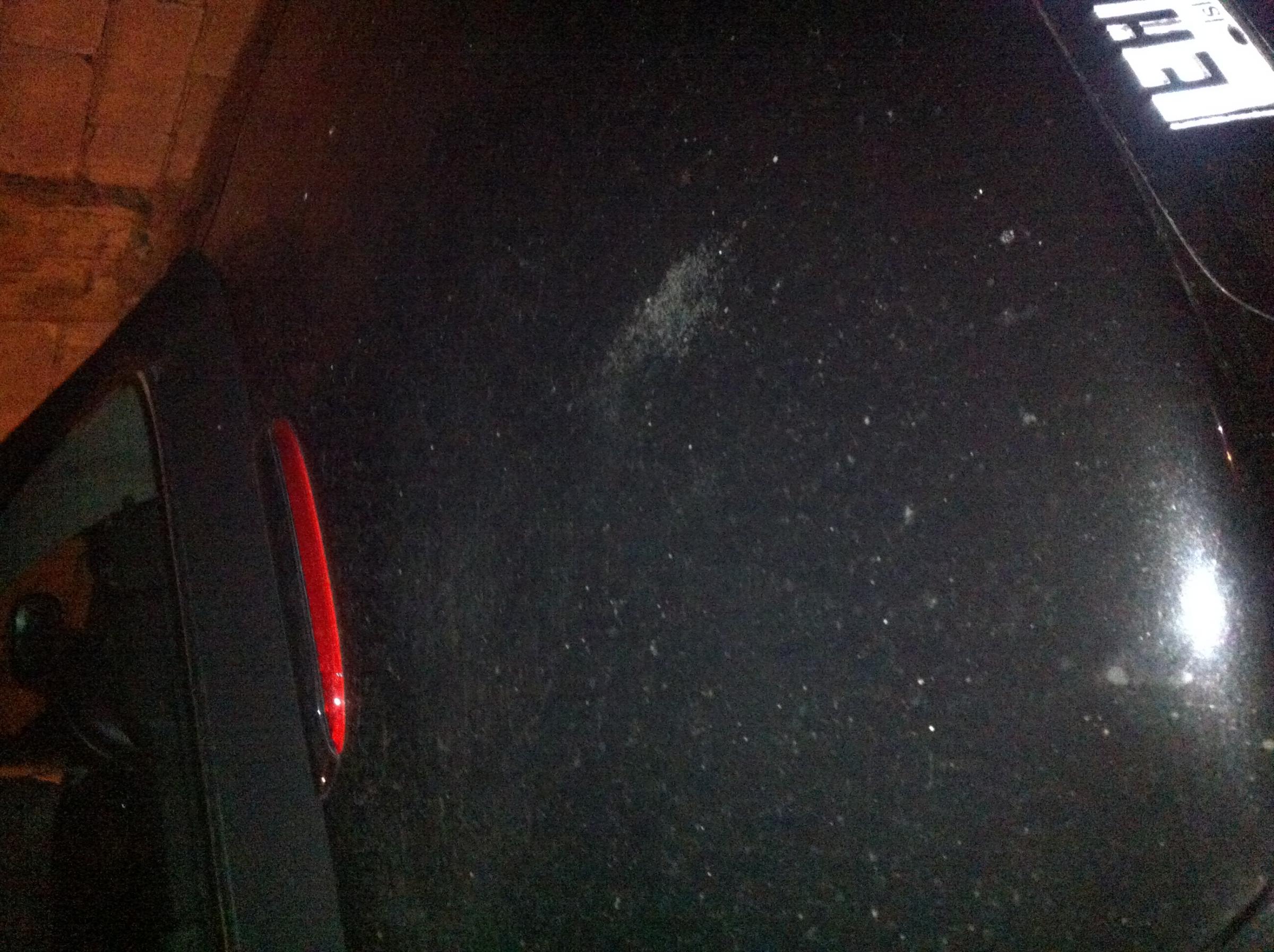

Phil, what about this on my boot; what is it?
Anyone else having paint crazing on front? Paint job much bigger!!-img_3555.jpg

Holy crap Phil, that looks real bad.
So, what's the recommended procedure with a clear coat failure? And why does it happen?
Ok. I'm actually calling my brother on this!! He used to paint cars.
He says either they didn't wet sand enough and clean residue before clear coating, or there was some contaminant between color and clear, or the last possibility is that they used a not compatible clear coat for the base color.
Every layer of paint depends on the final prep of the previous coat.
If someone like Maaco does a 99.00 bumper repaint, they do the least amount of work, and usually it looks good for a year or so, then it will start to fail. He says "you get what you pay for!"
