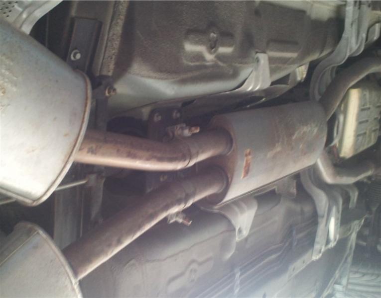

Default deleted middle muffler, added x-pipe PICS
2002 XJ8
It is not any louder in the cabin, and now you can hear a little lower tone from the rear while standing behind it. Very subtle, but noticeably improved, and the butt-dyno likes it too.
Probably less than a 5 hp gain, but I would do it again.
everything else is stock for now. I may change the mufflers in a few weeks if I want to take another step in this direction...
Attached Thumbnails Anyone have exhaust mods ?-x-pipe-before.jpg   Anyone have exhaust mods ?-x-pipe-after.jpg   Anyone have exhaust mods ?-2012-01-17-13.27.30.jpg

Hey newby, welcome to the center-box-delete crowd! I had an urge awhile back, thinking I wanted it louder, but after a year, I am really glad I didn't do anything else to mine. I'd recommend driving it for a bit, let family and friends give their opinion if they like how it sounds (only mention it in passing w/o making a big deal about it) and then you'll be able to answer your own doubts about more mods down the road.

Originally Posted by Newby
2002 XJ8
Does the XJ8 have more soundproofing than an XK? I would think by the nature of the vehicle it might. If you're a lead foot, you probably would notice more cabin noise. I did notice quite a gain on both of mine.
