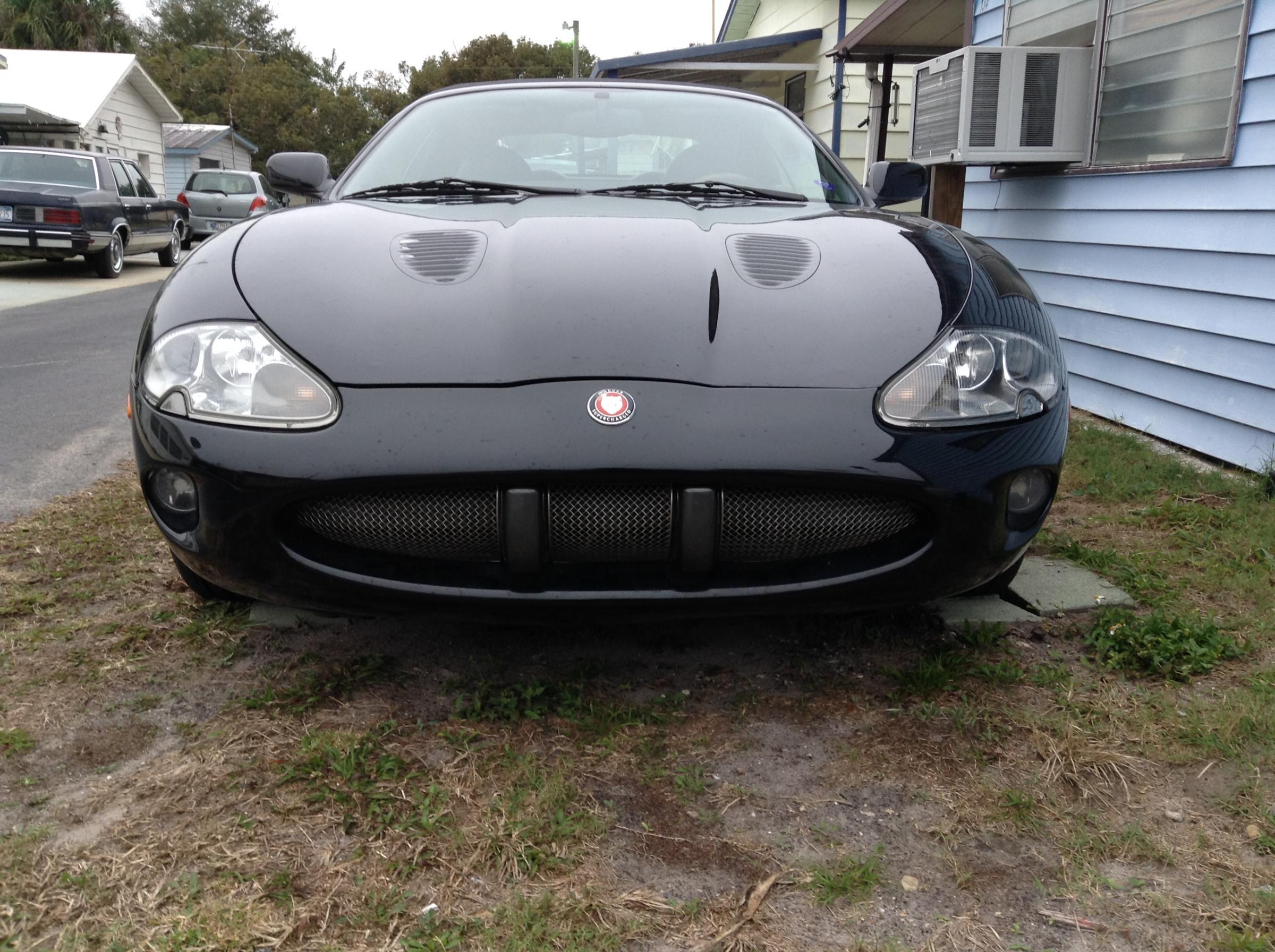

I'm in the process of installing a flat black grille from Mina Gallery, which I probably wouldn't have attempted without reading some threads on the subject in this forum. I have the nose off, as well as the splitter and the outrigger covers, now just need to remove the two center outriggers. The grille will be recessed (not flush) with the opening in the nose, and I have a strake/splitter from the 2006 XK8 installed on it. Hoping it will pay homage to the original E-type front end, which I've always loved.
I'll post pictures when I'm finished.
Old Jan 20, 2015 | 05:23 PM
  #35
stetson1's Avatar
Joined: Dec 2013
Posts: 333
Likes: 35
From: Central florida
Just repaired the front of my '99 XK8, with the front of a 2000 XKR. Still need the hood aligned but like the new look!!!

I thought I’d follow up with some pictures of the end result of my grille replacement project. My original intent was to attempt to have my 2000 XK8 pay homage to the original E-Type nose. After some suggestions from others on the forum (thank you all), I contacted Mina Gallery and discussed with them how best to proceed. They suggested a black mesh grille with a strake from (I believe) a 2007 model which they were able to provide.. The project which, seemed simple from the outset, took longer than I estimated due in no small part to my working in a poorly-heated garage during the worst winter in years. While it’s not as close to the original E-Type design as I would have liked (see attached file), at least the black “fangs” are gone. Many thanks to Chris at Mina Gallery, who patiently answered numerous questions and offered suggestions when I got stuck (which was more often than I care to admit).
I’ve also attached a picture of the round circle on the nose where I removed the original medallion. My plan was to fill in the mounting holes with Bondo, sand the area smooth, and use my Dr. Color Chip kit to blend in the paint. Unfortunately, I hadn’t counted on how much the paint had faded over the last 15 years, and I now have a clearly darker circle to deal with, which limits my options to either having the entire nose professionally painted, or finding a medallion or badge that will cover the circle and while maintaining the front styling aesthetic. If anyone can offer any suggestions as to how this can be addressed easily and not too expensively, I would be very grateful.

You'll be happier if you have it totally painted. Usually it's not that expensive especially is you can take off the bumper, repair the holes and then pick up after done. Re install yourself. Saves labor.
You won't be happy with a second badge. I tried the same thing and bought one of the winged jaguar badges. It covered holes but the faded paint and the faint circle left from the badge always showed. I think I paid about 150 to have the nose painted.
