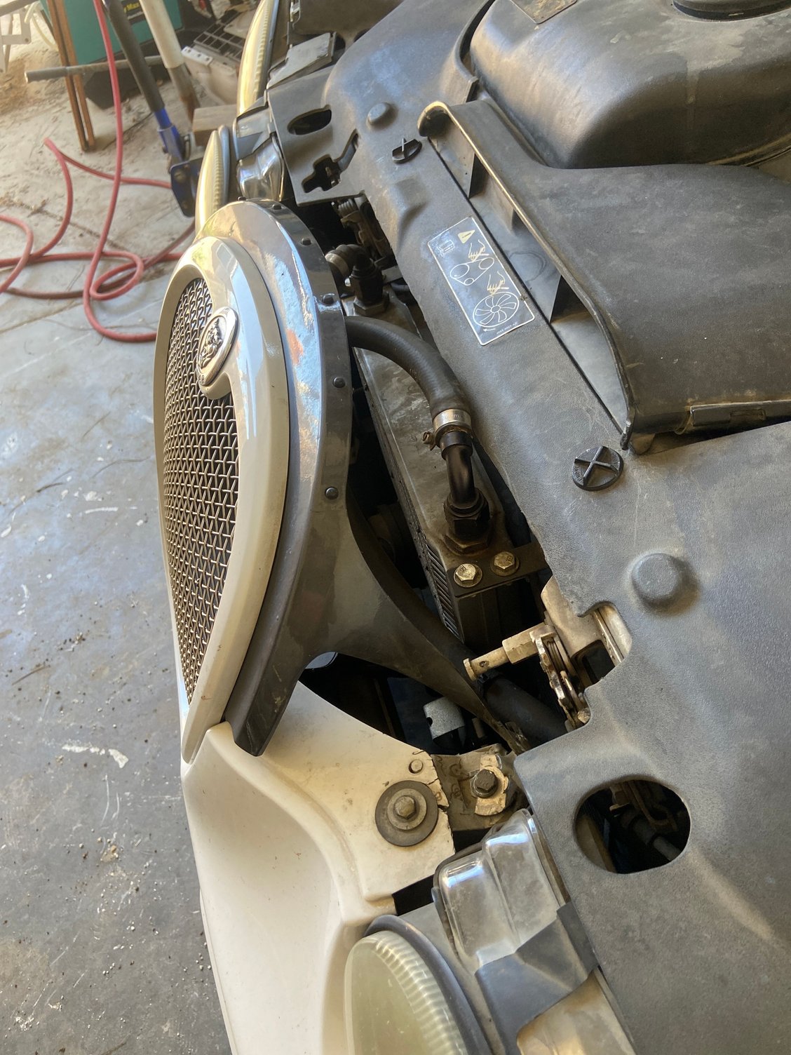

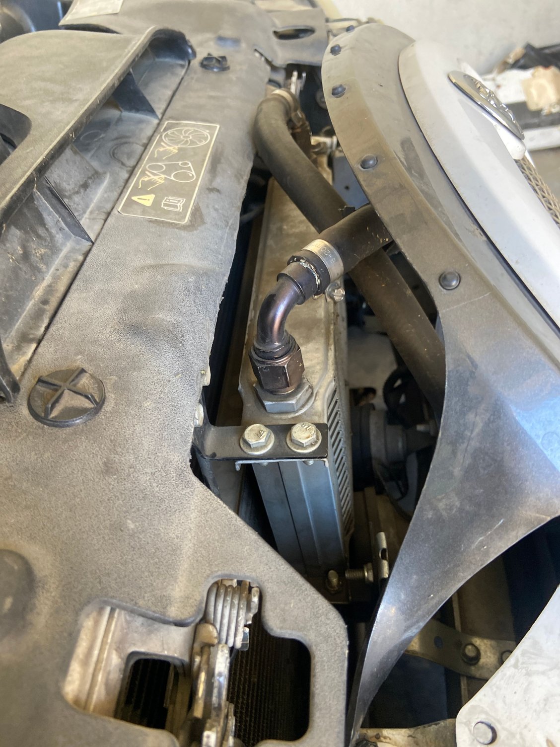

i put one on my 06 str. Looped it in to the cooler in the radiator. Works great. Especially in summer. Dont know if you have same space on your car but it was easy to mount and tie into the existing cooler lines
