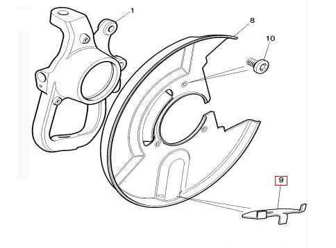

Anything to be done about rattling front brake dust shields?-brake-shield.jpg
3 x item 10
1 x item 9
Inspect for damaged shield or loose fixings.
