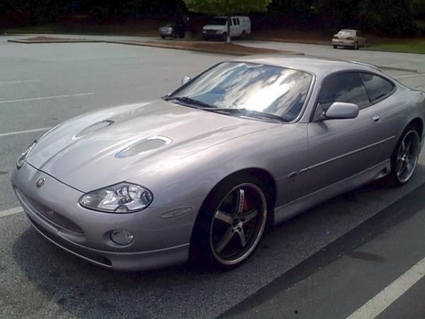

I had Arden kit since 2007...on 97 XK8 and 2002 XKR... Yes, front spoiler will stay on... only problem is... it will get damage from any hump on the street. (parking lot to driveway)
-You need to drive in angle...
-I put "garage door bottom weather strip" from homedepot with hard plastic strip.
(it will help the paint job... and it's cheaper to replace it, when it get damage)
or you can try ebay: Front Bumper Lip Splitter Chin Spoiler Body Kit Valance Trim Wing (Fits: Jaguar)
