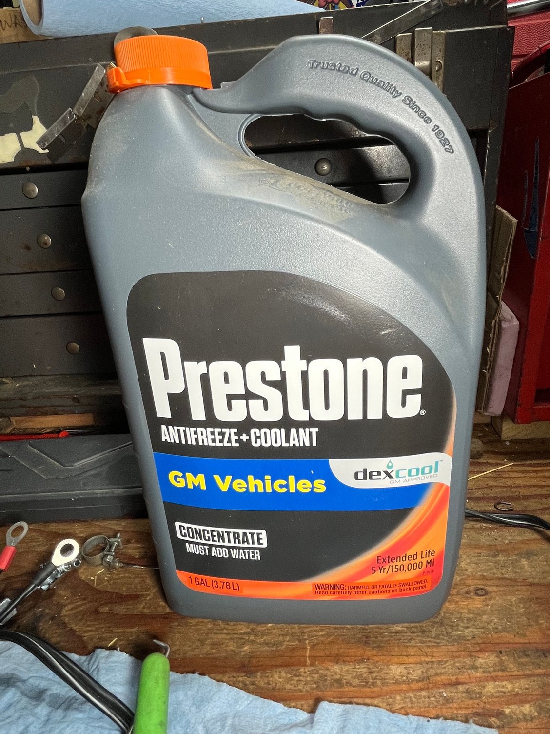

heres what use in my 2002 XKR. I don’t have any overheating issues and I drive in the hottest part of the USA. Many long distance trips throughout Oklahoma, New Mexico, and Texas every year.
You would have to contact Prestone to see what standards the coolant meets.

+1 on the Prestone Dexcool. Have used it in both of my XK8s past and present.
