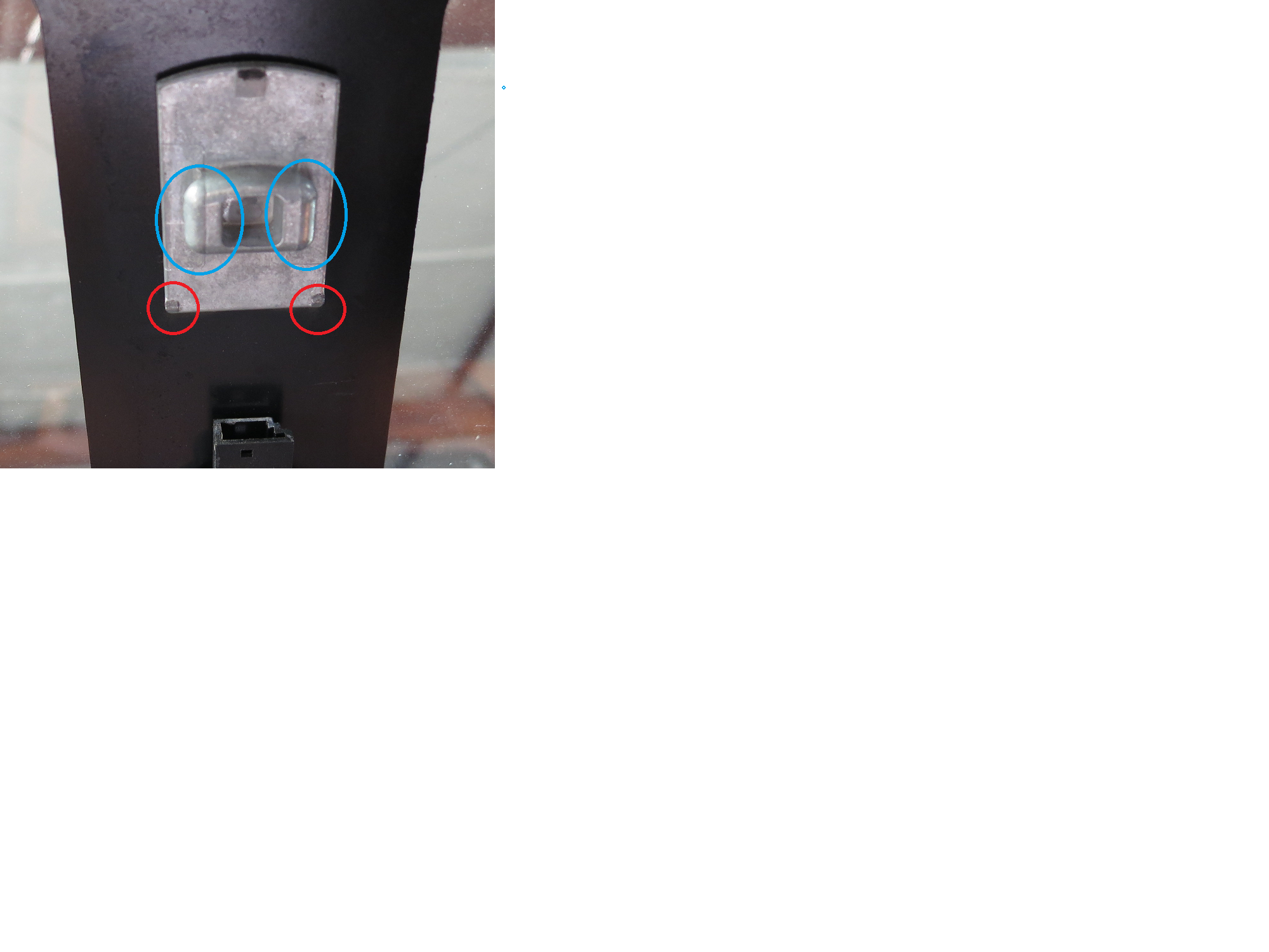

Folks - I'd like to point out two or three things about the rearview mirror replacement/refurb.
1) The attachment to the windscreen is simple, but people describe it wrong. Please refer to the two pictures. There's a spring (blue circles) that catches the mount on the windscreen. Then there are two detents and bumps on the windscreen and the mirror that are at the end of travel. That little piece of tape on the screw doesn't do anything. It's not that center button that keeps the mirror in place. It's the detents and force of the spring. ONLY force the mirror down along the slope of the windscreen to get past the detents (1 mm) then past the spring (10 mm). Don't twist, bend, torque, rotate, wiggle along any axis. Simply slide it "down or up."
2) Earlier in the thread is a pointer to steps to bend the spring a bit to make the fit tighter.
3) Sybesma does a good job, under $100 at time of writing.
Pictures use color for context (red and blue) - sorry if you cannot see the colors for some reason.
