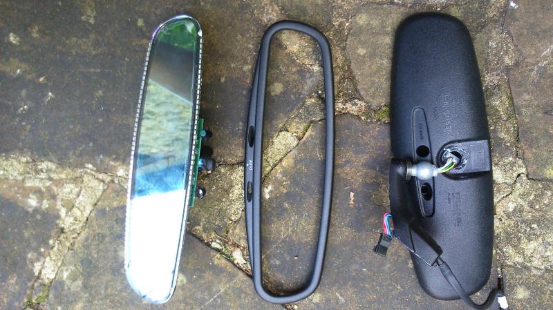

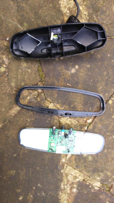

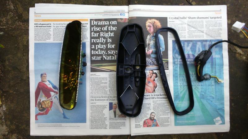

I got a second hand mirror from a later car with a different plug but with a broken mount. I was able to split my broken mirror and the newer one and just swap the mirror/electronics. The internal connections were the same. The extra plugs on the newer mirror are not for the mirror so no issue changing over
Old
Newer
Mirror rear view
