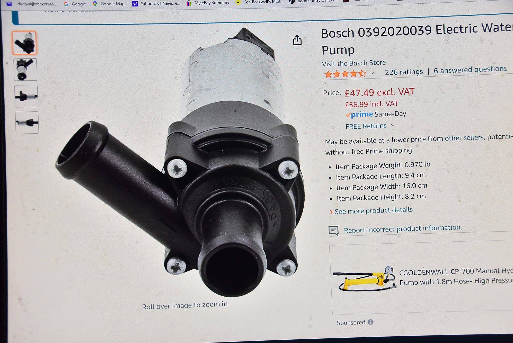

Bosch pump is 0392020039 would be great if you could tell me if it has a clutch.
Its fitted in the inlet to the heater core.
Its worked fine in the winter for months but the complication is that I ( idiot) fitted a none jag relay in the pump slot and I think I lost the earth via the ECU. Maybe I did not as at that time I did not know I needed the engine running for the system to work. ( just tested with ign on)
I have a relay buddied up with the water solenoid to turn off the pump when the solenoid cuts off the water to the heater core.

From: Devon, UK
Yes that pump has the magnetic coupling and is listed in the Bosch catalogue, the catalogue also shows a cutaway internal view showing the magnetic drive. If you are interested I have attached the Bosch pump catalogue.
I would leave your pump connections, that turn it on and off with the water valve, alone. I think that is an excellent solution and will increase the life of the pump.
