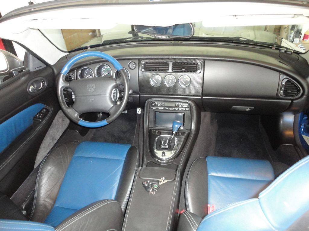

Hi Phil
I have a 2000 xkr and I'm working on an interior facelift... and would like some comments and ideas. I loved the wood dash on my 2000 XKR but I find the steering wheel to be more than out dated. I covered the wood dash with a fully removeable vinyl covering - the 3M Brushed Graphite vinyl like on Mystique. Then I had to get a steering wheel upgrade -
I didn't want to put an aftermarket because of the airbag law, I was concerned about getting a fine ... My option, turned out to be a 2009 XKR steering wheel. Would have an original look with an airbag look and a nice overall upgrade. I made the swap and connected the horn last year but then I had to attack the radio and cruise control buttons... I had to make my own circuit board to make them work - a lot of fitting and patience and this is the result so far... Buttons work - light on steering wheel light up etc...
I like the two tone with black and a chrome pin stripe that you did on yours and I'm still looking for a pattern I would love...
Ideas?

Nicely done but... did you get the paddle shifters to work?
Seriously though, that's a nice upgrade. Do the newer wheels just slide onto the existing splines without any mechanical modification?

Wow!
I'd have 'steered' clear of doing that myself just because it involved playing around with Airbags.
Whilst you've done it successfully on a 2000, a similar upgrade on 2003-06 model could give serious issues matching the newer replacement Airbag to the existing Secondary Restraint System monitoring system.

Wow. I've looked at my XF wheel and wanted it in my xk8!!! You've done it so now my brother has to make it work!! I'm not the mechanic, he is, I do the detail work so the wheel change is out of my comfort zone. I actually have a factory wheel being refinished in piano black but I really like you solution.
Well done!!!!!

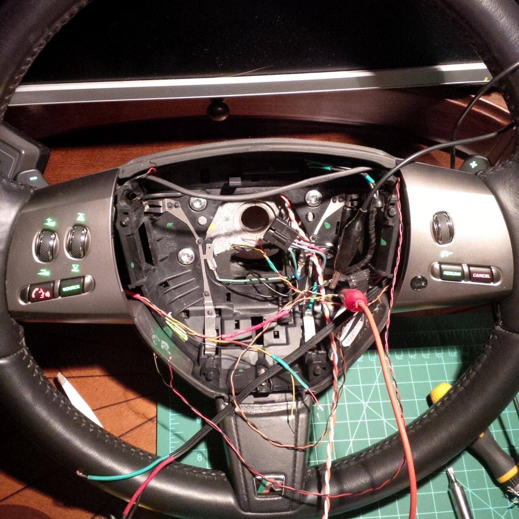

Thanks guys for your comments... The wheel has the same matching spline however the base of the 2000 steering has a slight taper. I had to use a 1-1/2 inch drill bit on my column drill to machine the steering wheel. I first had to grind the tip of my drill to the shape of the cone to match the radius of the shaft.
Paddle shifters ??... Well a +/- 2000$ upgrade would have made it possible to match using this from Racing Green...
http://www.racinggreencars.com/Jaguar/Parts/XK%201996-2006/d%7C.htm
But that was too much $$$ for me... So I just connected the +/- paddles to the cuise accelerate and decelerate buttons... works fine as I was looking of a cosmetic facelift not a performance add on...
As for the airbag... The newer steering wheel uses a 2 phase system that didn't match the one in my car. For the time being I have removed the bag and in its place I used a fused resistor to fool the computer. I will keep looking into this airbag issue to find a final solution.

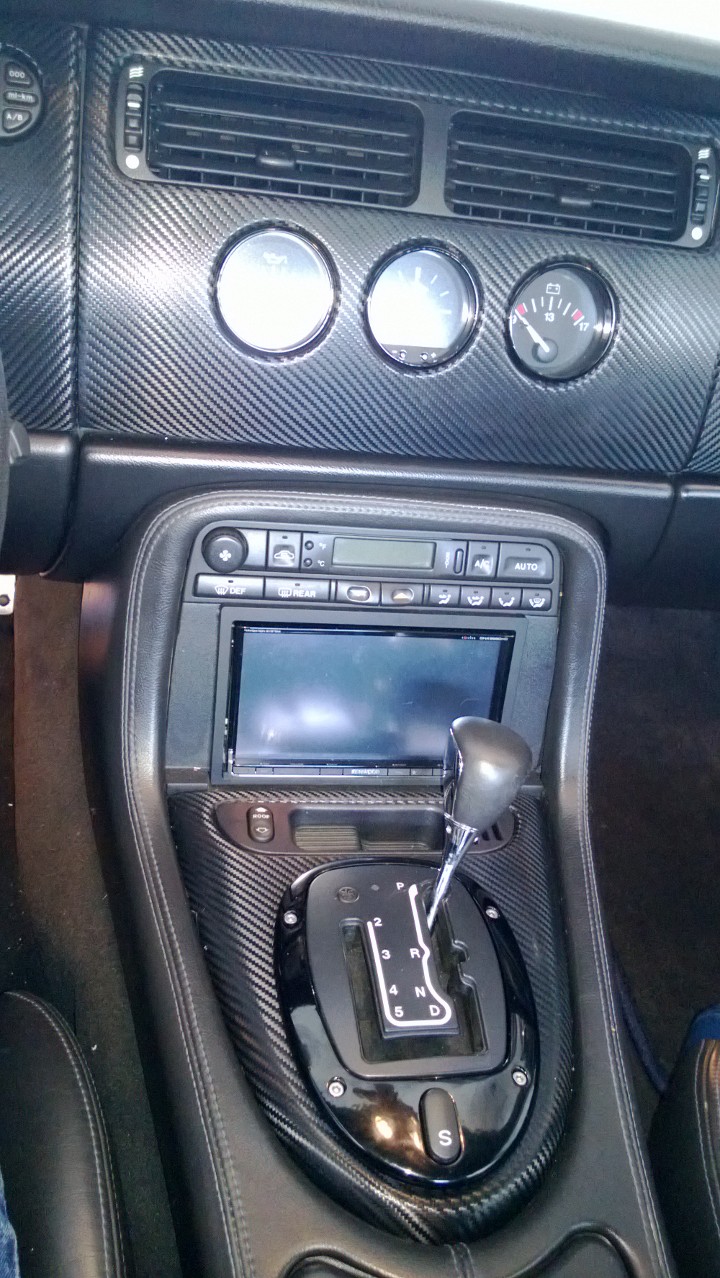

Hey Phil... what you have looks awesome... where did you get the "shiny cover" over the gear selector (not the chrome piece, but inside the chrome)? I like how it looks with the chrome... please let me know.

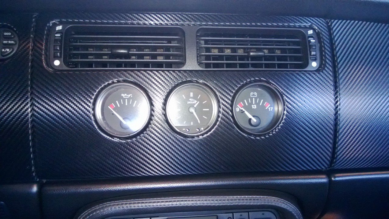

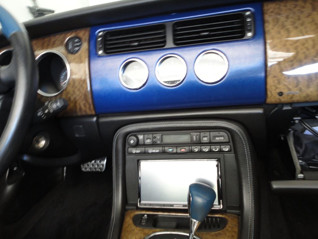

Pretty sure that is Titanium wrap. Once you learn how to use wraps you can have a lot of fun changing out how your dash and shift surround works. I've even wrapped my door handles.

If you mean the j gate face, I ordered a black dash stick in kit for ebay. I contacted the seller and he only made me the center console switch pieces, coin tray piece and j gate shifter. I never liked the plastic look. He said if I send him my ac vents, he will even make the piano black templates for them too.

How difficult was it to remove the center panel? I'm looking to change the now-useless DVD screen into something more functional.

There are 4 clips at the corners and it just pulls out. Can be a PITA , as the clips are metal teeth that grab onto a metal tab on the panel, so they bite pretty well.
Wiggle and pull, it will come out eventually. I found it helpful to take the gauge panel out so you can get a finger behind it.
