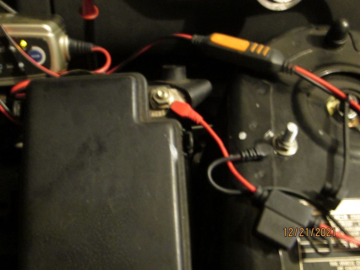

If you can run a cord to the car you can connect a maintainer under the bonnet, then latch it. See pic.

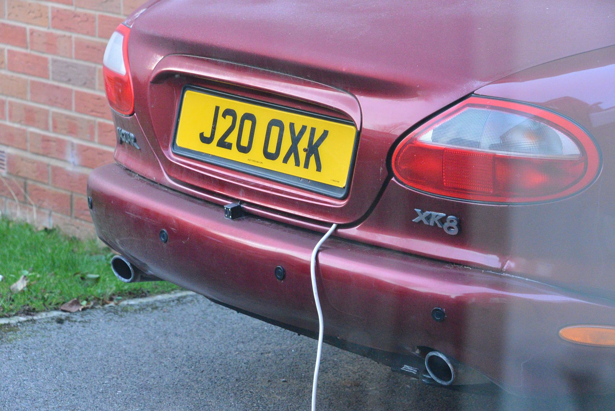

I keep my x350 on charge using a trickle charger into the trunk/boot, is it safe to connect it then shut the trunk so that I can lock the car when not in use? My only concern about this is whether gas released from the battery could build up in the trunk/boot if I shut it with the charger connected?
Is my concern unfounded?
Is it better to connect the changer under the bonnet/hood instead?

The battery does not gas until 14.5v so if its below that when its charged dont worry.
However you say a trickle charger which is a UK term and may imply a charger with a low output but still going to 15v . you dont want that .
My charger gives out 14.3v and I have a diode in series to drop the volts by 0.7v giving 13.5v at the battery . Yhr current drops to almost zero after a few hours.
