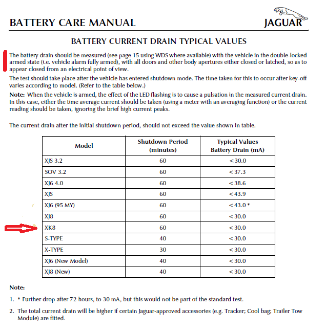

Hi again.
It should be 60 minutes to power down.
