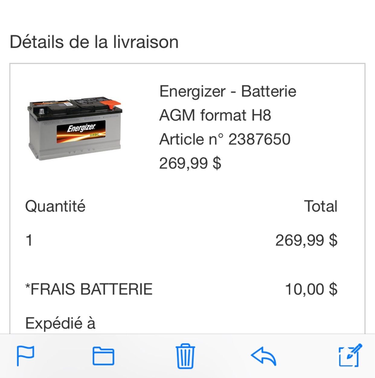

Default I bought mine via Costco
I bought for my Victory Edition an Energizer AGM H8 from Costco and delivered at the door in Canada for 269$ cad
i am more then satisfied with it. I stored the car with an intelligent low 2 amps charger.
