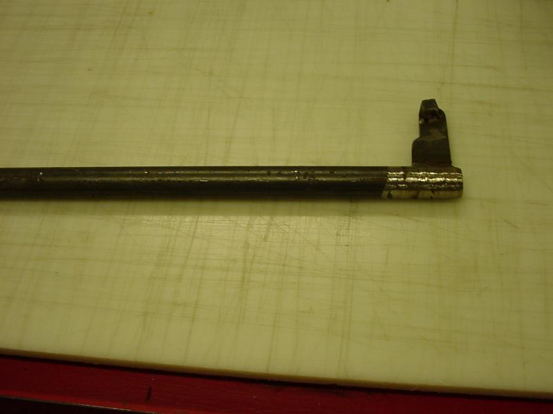

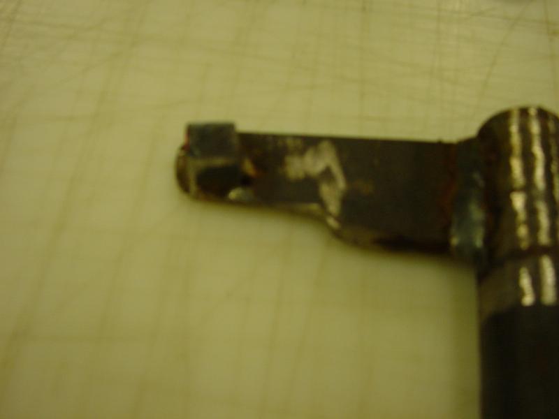

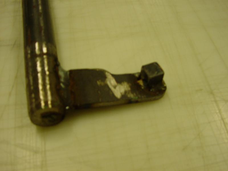

You can remove the both belts on the SC if you want to fabricate a tool without removing the fan or anything else. Here's photos of the tool I made. Takes about ten minutes to change both belts out. Took about 20 minutes to fab the tool.
Sorry Dennis I'm not wrong about this.
Attached Thumbnails Belt squeaking-dsc00988.jpg   Belt squeaking-dsc00987.jpg   Belt squeaking-dsc00986.jpg

the space between the fan *** and the sc belt tentioner on my car is about one quarter of an inch .. I have the updated double sided belt kit so even your tool would not go into the space..most ordinary people dont possess welding equipment to manifacture there own tools so have to use what they have to hand.pictures to follow

Can replace a belt within 5 minutes max (could be 10 minutes for a 4.0 car), you could even use a wooden stick (a wide one so pressure gets evenly spread on the belt) to release the tension if you don't have/can make the tool. Best is of course the tool...
