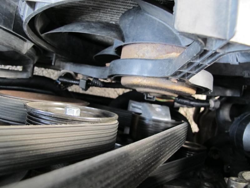

this is a picture of the space between the fan and sc belt tentioner and there is about a quarter of and inch space..impossible to get a drive in..fan *** MUST come out
pictures didnt upload..working on it

I can only see your car in your sig ;-)
Actually, 1/2" is enough, and you can push the fan a little bit away, so not really an issue. But, and here is where I can't tell if it will work, the double sided belt is a little thicker and might be harder to squeeze out on a 4.0 car. The 4.2 cars have a thinner fead belt pulley (behind the SC belt pulley), and here it will be easier to get the double sided belt out.

can you see my pictures now?the one i used first were to big to upload
thanks
Old Oct 24, 2011 | 06:34 AM
  #29
avos's Avatar
Joined: Apr 2008
Posts: 3,616
Likes: 1,070
From: Europe
Now I can see them, and there is enough room from what I can see.

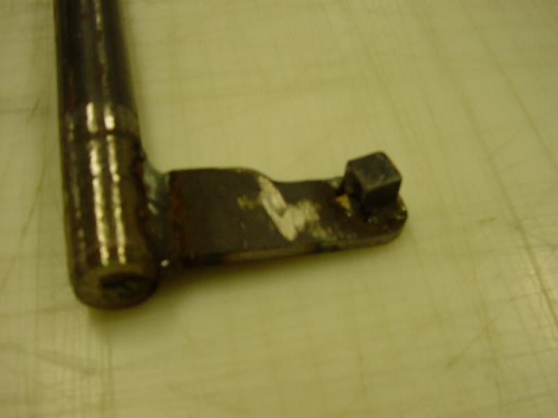

For the sake of argument I replaced my belt twice, tensioner and idler without removing the fan housing. To release the tension on the tensioner I used a socket and a breaker-bar to remove the belt, socket and ratchet for the tensioner and idler. This R&R can take place in less than 1 hour on a 4.0 non-super charged engine. Belt Tentioner
I guess the question is can it be replaced without removing the fan assembly yes on a 4.0. As for the 4.2 I am unable to answer that question because I never did it. If you elect to remove the fan housing place a cardboard over the radiator to prevent accidental contact. Damage to the radiator could make you regret you ever took this project on. I hope this helps.

Your clearance looks like mine there is not much room but Avos is right the fan assembly will move slightly to allow it The only difference between Avos's tool and mine is I offset it so you would come in from the side instead of from the top. It really is a time saver and if you can get one it's well worth the money.

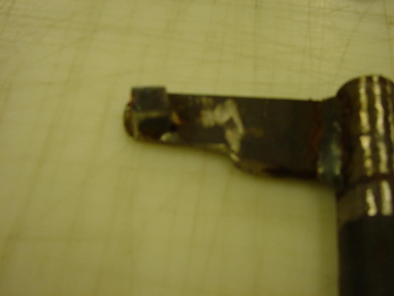

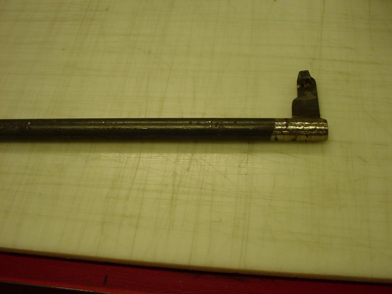

As we seem to be comparing tools I thought I might as well post my own creation up.
Lightening holes for extra speed
I turned mine up and then milled a 1/2 inch square on it, drilled a hole in a piece of 2 X 1/4 X 24 long, pressed it in, turned it until I got the correct angle and then welded it up, works a treat
